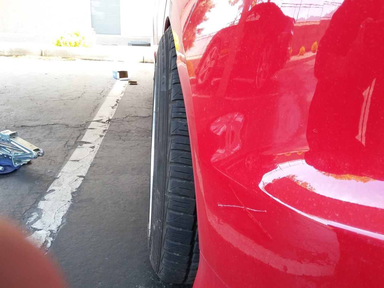

just get the right offset to begin with. on a lot of cars, including the ge8, rear wheels have about 12mm more fender clearance than fronts. personally i wouldnt offset the rears more than 15mm if you are not spacing the front because then it becomes obvious.
rubbing tires because of low offset wheels gets old quick. you risk cutting tires and denting fenders. your only hope is if your bump stops bottom out before the tire hits the fender.
heres an example of what 15x8 20et with 195/55-15 looks like. definitely not functional.
front/no drop
rear with 2''drop
