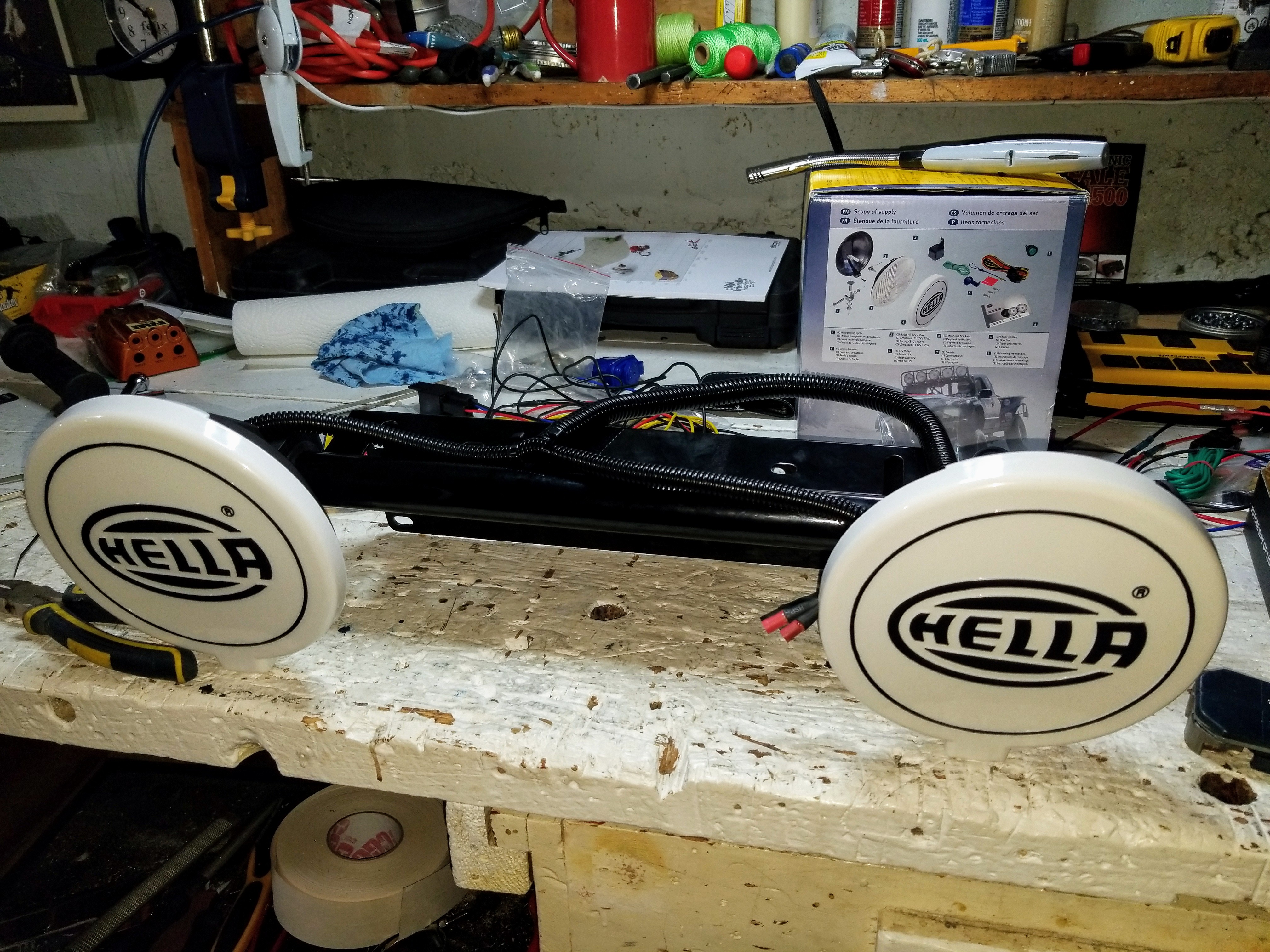

Put the lights on the mount and made up a removable harness.

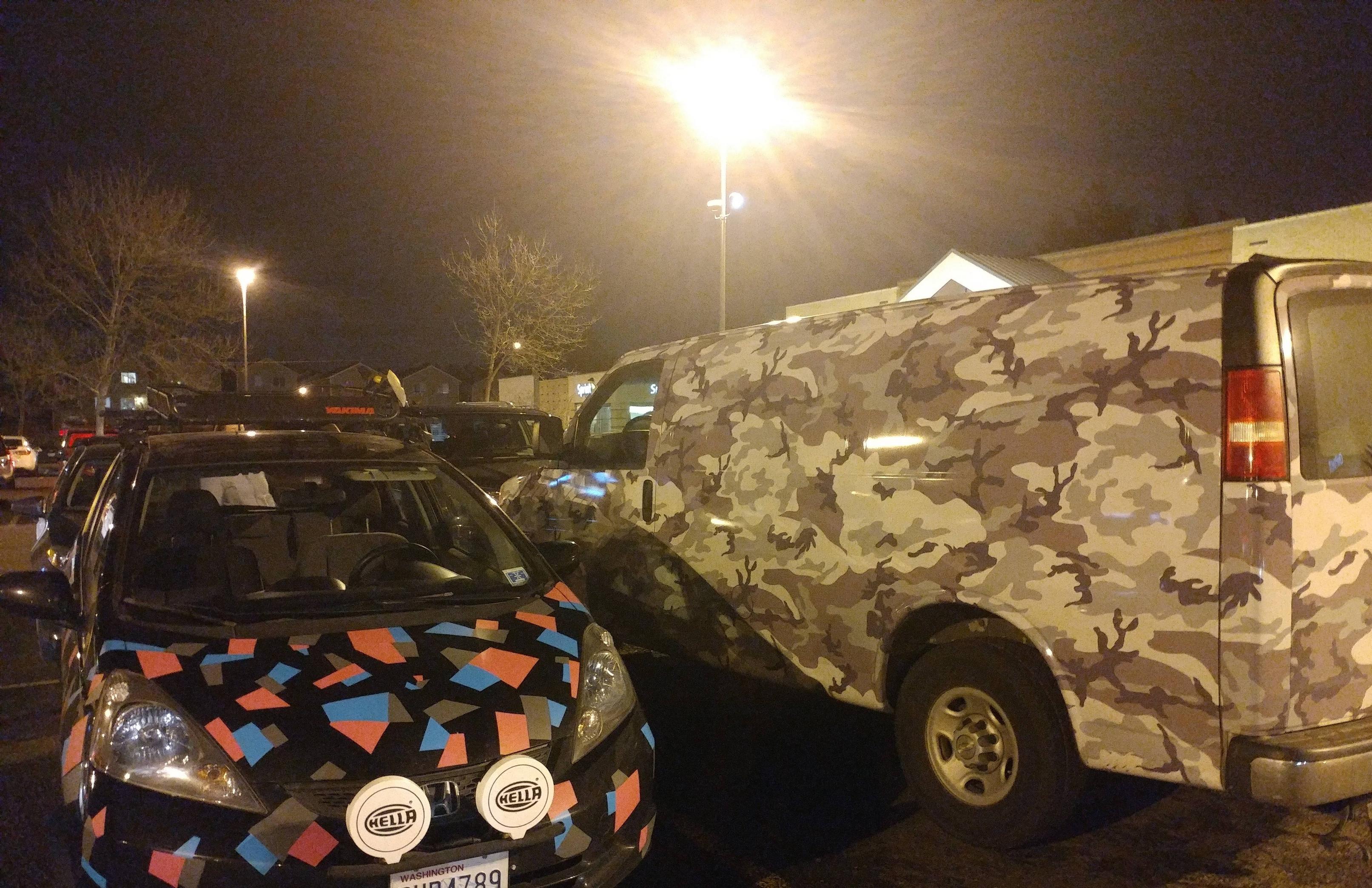

Old Feb 18, 2019 | 03:14 PM
evanphi's Avatar
Joined: Dec 2018
Posts: 66
