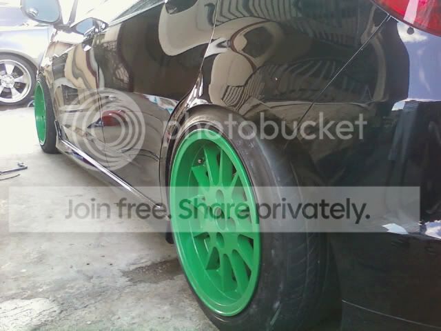

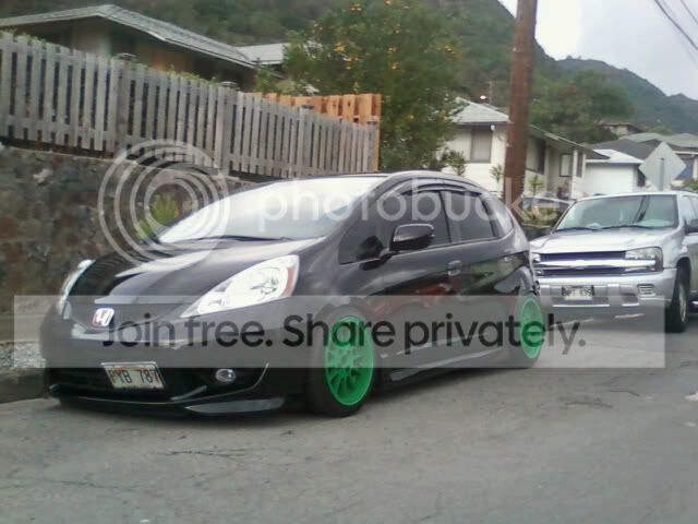

very nice,big thumbs up.. similar fitment to what my plans are after i get coilovers .. wut suspension r u running and wheel and tire specs and did u roll ur fender.. cause u kno ppl are gunn ask lol

rims are alright but the stance makes me wish i got an GE

very nice. i see u bought that guys car from FH...respy1? or something like that? did u roll/pull urself or was it like that wen u bought it? looks like u lowered some more.

i am respy1 on FH no one didnt wanna buy it so i just decided to keep it but yups i rolled the fenders myself but it still rubs and before i had tanabe drop spring now i have megan coilovers from a gd

suspention
megan coilovers for a gd
wheels
16x7 1/2 +20 offset front
16x7 1/2 +15 0ffset rear
tires
195/45/16 front
205/45/16 rear
and yups i rolled fender and chipped the paint but its all good
and thanx im glad you like it man

LoL. my bad. i thought u posted it sold on forums. did u space the wheels out? that's some crazy offsets u runnin'. very sick car indeed. so did u buy dielawn's coilovers? i was contemplating on buying those back then but wasn't too sure if it would fit.

yups i have 5mm spacers in the rear but my friend bought the coilovers from him but he didnt want it so i asked him if i could try it first and it fit but had to do some customizing like the rear shock is thicker than the ge so had to grind it down to fit and the brake lines in the front is just held by zip tyes

the ride is bouncy but i didnt get a chance to change the dampers on it but driving that low sucks cuz it scrapes everyewhere i go but i like how it looks lol
