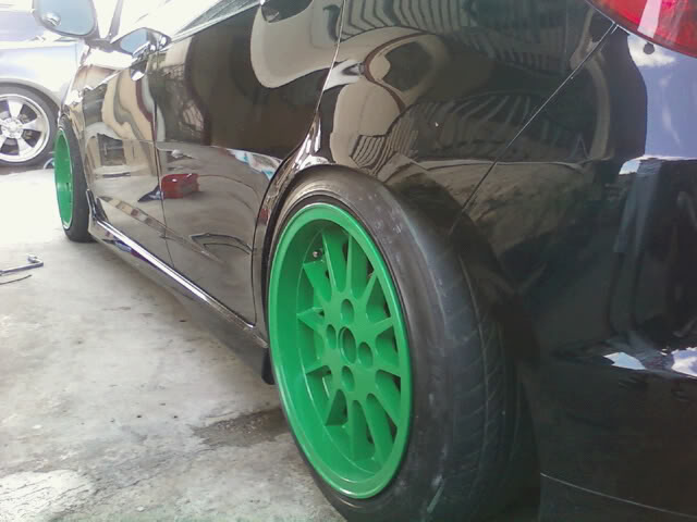

Old Feb 2, 2010 | 03:16 AM
flushge8's Avatar
Joined: Jan 2010
Posts: 51
From: Honolulu, HI
here are the pics
