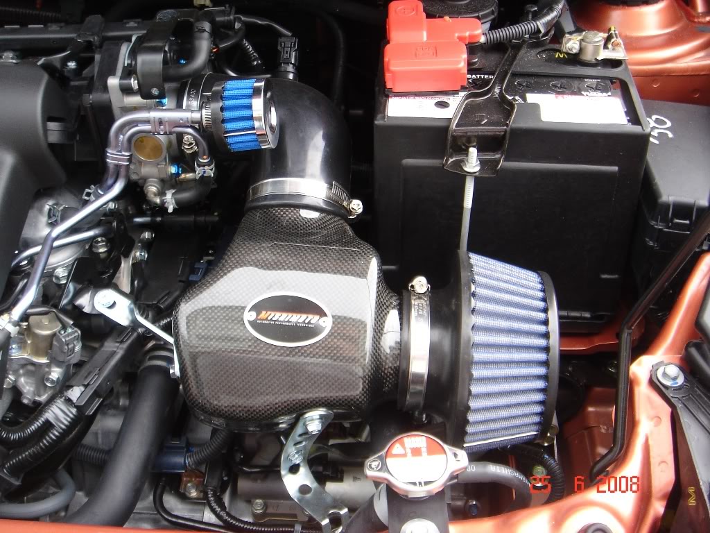

I had only one problem with mine. I have an AT BTW. The bottom bracket needed to be bent a little to not rub on my Transmission. Very easy though. As for rubbing on the hose, as soon as I looked at it I knew there would be problems so I made sure to mount it under the hose and have not had any problems. Here is a pic:

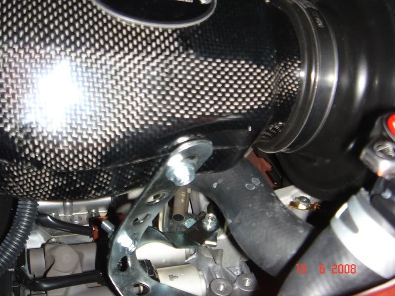

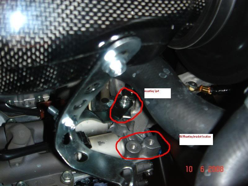

Here are some more pics with a better view. For anyone else who comes up with this problem:

I used the stock rubber mounting bushings. It will have a bit of clearance. Once the engine heat up the radiator hose expand a tad and it will then rub. That's why I mounted it like Comtrekkie.
