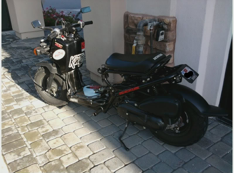

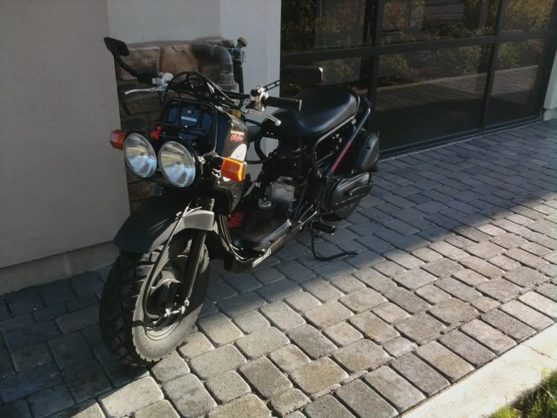

So I embarked on a new little project. I picked up a Honda Ruckus to commute to work and save gas (100mpg was awesome). I love this scooter… but it was SLOOOOW! I immediately knew I was going to swap the motor out. I started acquiring the parts and got the swap done. Heres a little build thread to where it is now.. I still plan on painting it and some other go faster goodies.

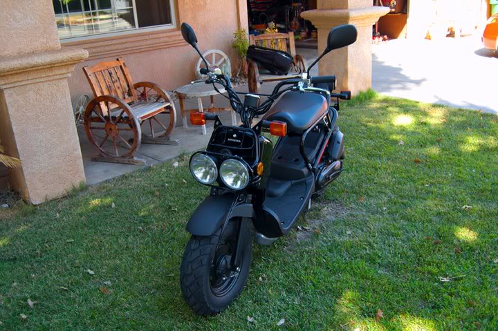

before tear down

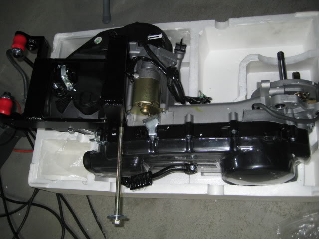

Engine and prototype mount

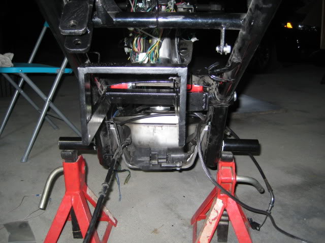

Encountered issues during the swap, prototype mount was way off..
ditched the prototype and installed a Killerscooter mount.

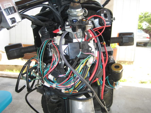

Harness installed

Killer Scooter mount installed and harness tucked a bit

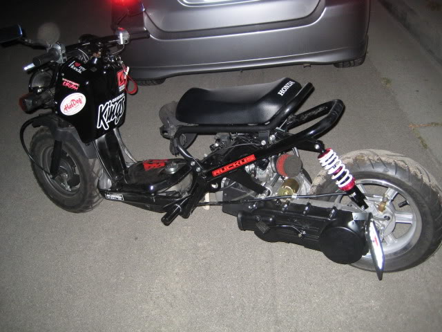

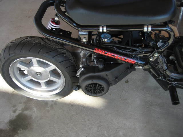

How it sits as of now

its a GY6 150cc motor. "Chinese Honda Clone" my top speed so far with all stock CVT was 63mph.. I just picked up a variator, wider kevlar belt and slider weights.. hope to get closer to that 70mph mark.

Word to the wise: Keep a good eye on that Kevlar belt. I had one snap on me while driving my kart 2 years back. The Kevlar somehow got behind the variator and cut the seal for the shaft it rides on. Gave me a nice steady oil leak and I never used one again.

I picked up some 10g sliders and am using a dr pulley variator and clutch spring. Stock CDI so far.

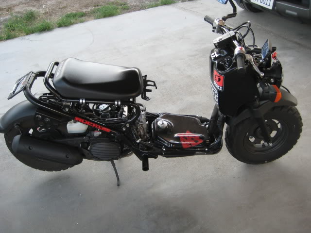

Got my fender on today and went for a ride with some of the locals!
