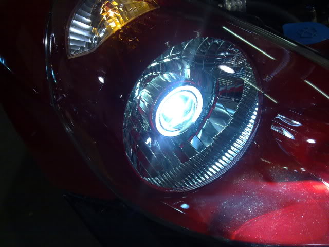

here's my contributions
6000K w/ white halos

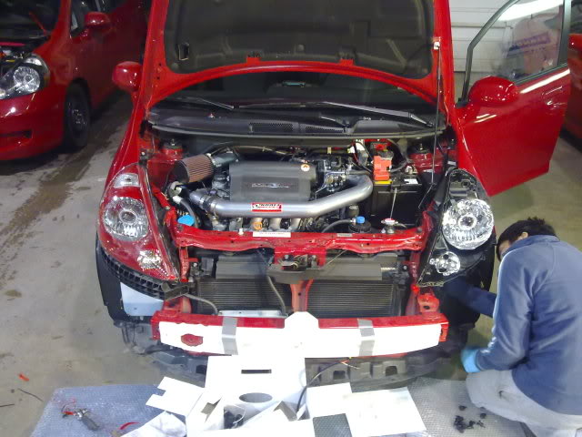

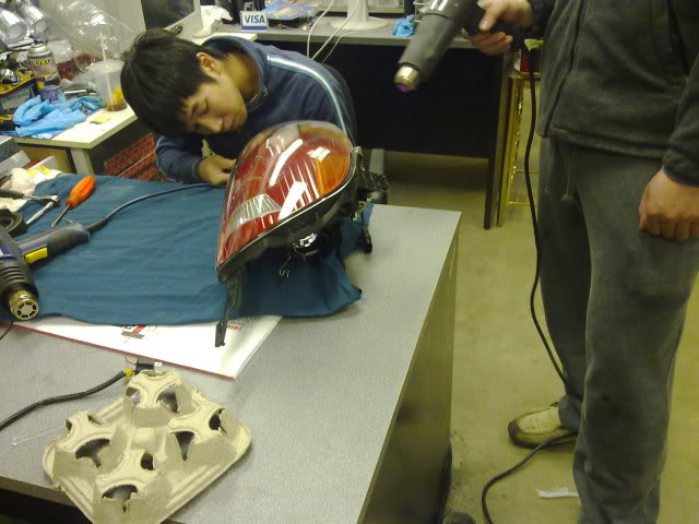

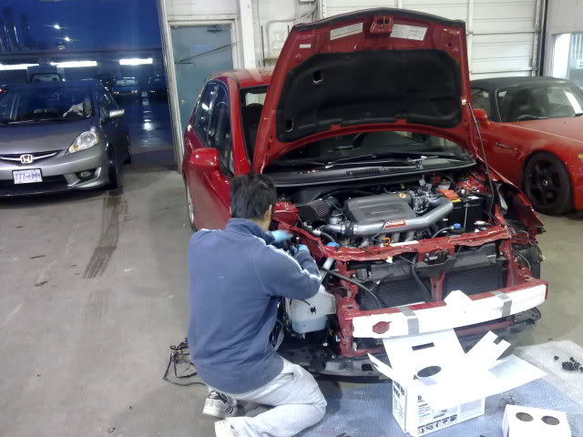

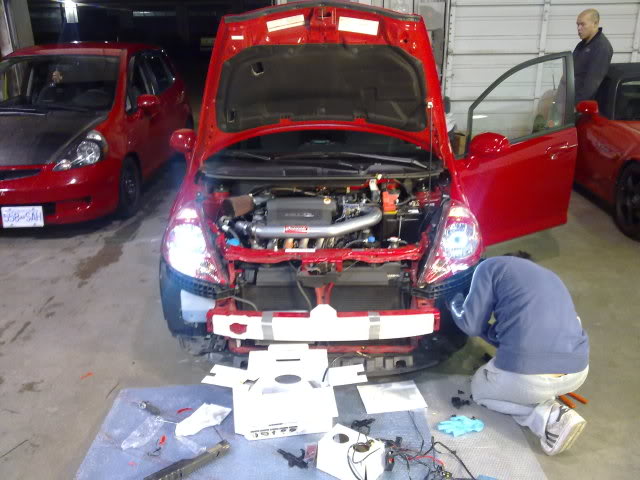

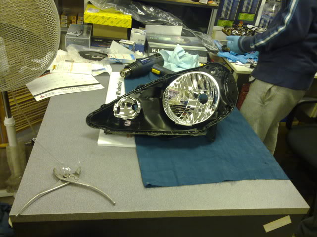

Sorry for the wait everyone! I had left the transfer cable for my phone at the girlfriends house. Anyways! Here are the pictures from the install day.
NOTE: I totally skipped the wiring part! You need to wire wire wire things up!
Remove headlight.

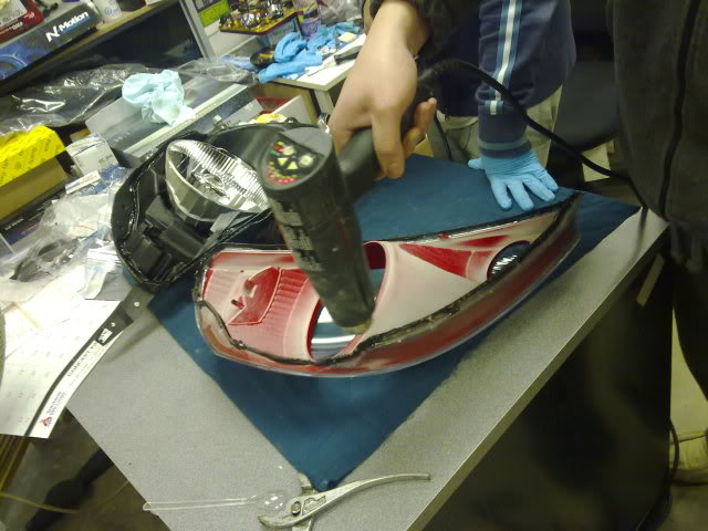

Bake/Run under heat gun.

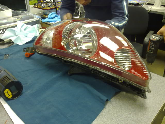

Carefully pry open from bottom.

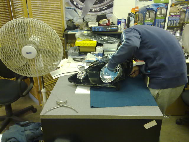

Remove clear headlight housing.
Unscrew and remove holder for non-HID bulb.

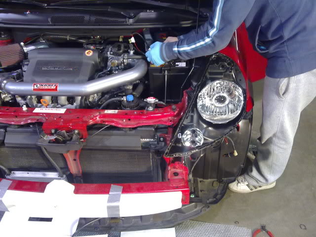

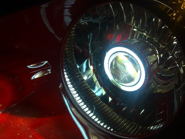

Screw in projector lamp and secure all washers and bolts in the back.

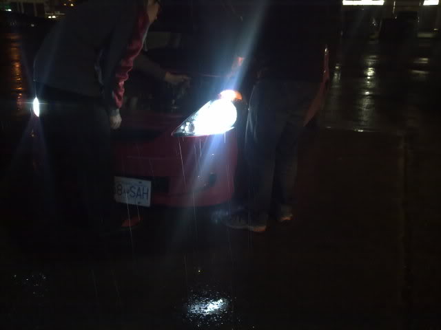

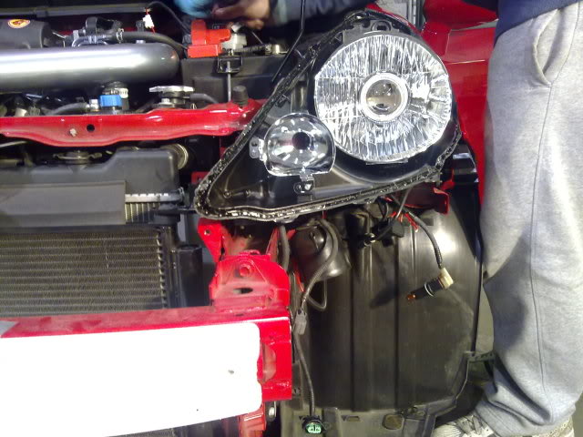

VERY IMPORTANT: Test fit and AIM before putting headlight back together and on.
DO IT RIGHT THE FIRST TIME! Or drive around for a bit and then re-adjust IN THE RAIN!!
Reheat butyl that is already on the headlights from when you heated them up.
Push them back together, while applying heat so it will go back together smoothly and without a hitch.
Test fit re-sealed headlights and wire them up, once again AIM IT PROPERLY before putting everything back together. MAKE SURE the lights turn on, and the Angel Eyes work.

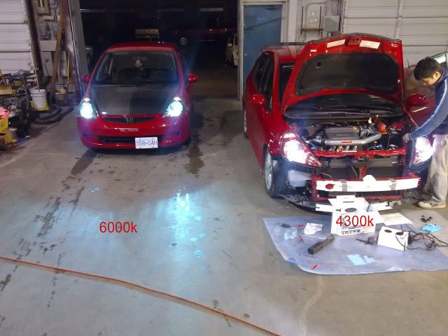

Finished products.
6000k vs 4300k
Everything off.

In the picture, which 1 is 4300 & 6k ?
