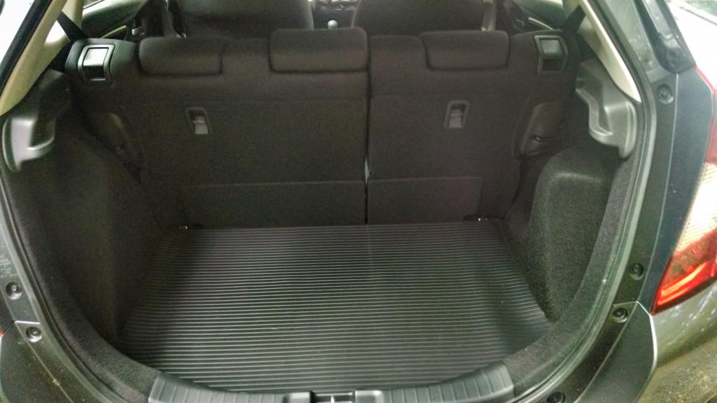

I know this is nothing new, but I'm pretty pleased and thought I'd pass along a few (crappy) pics. I didn't weight the vinyl before I cut it, so it's still got a bit of a bow/curve to it. That should settle out, but it's visible in some of these pics. The covers are much less rippled than they photograph, and don't sag at all.
Materials:
-9' of vinyl runner @ $2.27/lf ( Multy Home Black 27 in. x 72 in. Vinyl Runner-MT5310063US at The Home Depot)
-18" of adhesive-back Velcro $1.50 (might need more, we'll see)
-heavy duty scissors
-newspaper
-chalk
-marker
-about an hour of time
seats down:
seats up:
no seat back covers or flaps (this uses a hair over 4' of mat):
60/40 split:
Overall, I'm super pumped at this $22 project! This is for everyday sorts of stuff. It doesn't cover everything with the seats down, so if it's a messy job, I'll use a tarp.

Brought my first fit home today (2015, red) and interested in your cargo mat idea. Looks like you cut all the pieces and then velcro them to the seat back and bottom of cargo area? And you leave all in place as you put the seat up and down? Any tips welcome.
Yep! Cut the pieces out (then trim to fit). I velcroed the seat backs and the flaps, but not the cargo area. It's tight enough that it isn't likely to shift around, but if it does, that's easy enough to fix with more velcro I did seats, cargo area, and flaps separately so it all stays in place whatever the configuration is.
Two things I forgot to mention earlier that may be relevant:
1) The cargo area is around 27 3/8" at its widest part. The vinyl runner is 27" wide. This means a small gap somewhere. I decided to have the 3/8" gap where the cargo area bows out at the hatch latch. That bowed part is only a few inches on each side, so it's a small gap. You could choose to have the gap at the back where the seats are and try to cover it with extra length on the flap covers.
2) The carpet provides sufficient "loops" for the velcro. So all you have to do is adhere the "hooks" side to the back of your mats and stick them to the carpet. This means that if/when you remove your mats, it's instantly back to factory. No other fasteners left behind and no permanent changes to the car. I did not use industrial-strength velcro, just regular.
If you need more tips, I'm happy to share!
