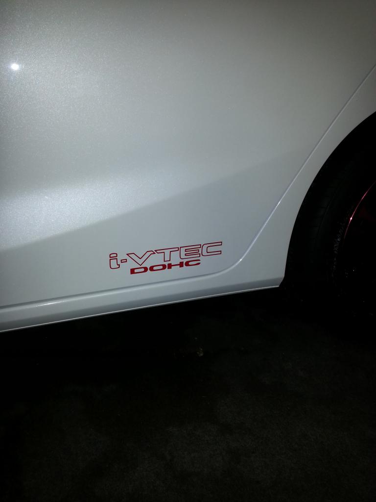

Yessir, only around 9 bucks for a pair of 2 off ebay! Vendor in CA! The tricky part installing those decals is first need to wax the area, clean with an alcohol pad, and SLOWLY peel way the protective backing without lifting the letters off the other side that hold them in place. I used the same squeegee that was included to put on the rear bumper applique making the job much easier!
Likewise got my i-VTEC stickers from Ebay.
Cost was $3/pair w/ Free Ship. Multiple colors available.
2 X I-VTEC DOHC 9" X 2" VINYL DECAL STICKER STICKERS HONDA JDM USA SELLER: sfcustomdecals
