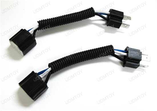

DRL PWM issue: Constructing R/C Low pass filter
Still researching and testing. The pulse signal for the DRL circuit can be smoothed out to a constant voltage to allow for correct LED operation and not strobe/flicker. The only issue I think might happen is a smoothing cap will bring the RMS voltage from ~8-9VDC to full 12VDC, causing the DRL brightness to be at full power on the high beam. If that's the case then nope back tot he drawing board.
I plan to use a properly sized diode to prevent backfeed into the DRL and high beam circuit. Depending on the resistance of the high beam circuit of the LED controller I may need a bleed resistor across the cap too.
The R/C LPF looks to be the most convenient and readily available parts at rat shack. I may try an R/L LPF but I would need an o-scope to accurately measure the frequency of the PWM and size the inductor properly for frequency and amperage.
I ordered this adapter so I can add my proposed filter, and avoid cutting into the stock harness. It will also serve me well if my filter design does not work and I will need to figure out another solution, possibly with relays.

DRL Circuit Update:
A few things discovered:
1. It is mother effing cold in CT right now cannot do much outside
2. There is no fuse #17 in the under hood fuse panel. The space is empty.
3. Fuse #25 under the dash disables the DRL circuit completely. (thank you thaipinoy1!!)
4. The DRL circuit (connected to the high beam hot connector) seems to power BOTH the Low/High beams of the LED kit. The low beam is steady on, and the high beam is strobing/flickering. There is no brightness difference between normal/DRL mode. This likely negates building an R/C filter, but the parts are on their way.
Next steps:
1. Install the LED headlights and foglights and disable the DRL circuit for now. Its just too...fucking cold outside in CT! That we have another foot of snow coming Monday...so they say
2. Build/Try the R/C filter with two 4700uF 35V caps and two 10A diodes with the pigtail harnesses (H4 male to H4 female) and see if this corrects flickering. This exercise may prove moot at this point since no brightness change between DRL and normal mode.
3. Back probe fuse#25 and see where in the DRL circuit chain its located. Likely it is the main power fuse to the DRL module but figure check anyway.
4. Determine if the stock DRL module output to the H4 headlight connector can be rerouted to say the foglights? To do this I need to locate where the DRL relay is located as well as the fog light relay.
5. Another option would be to leave the stock DRL module disabled, and install a universal DRL relay harness control. From there I can route that to either the foglights or new separate DRL's (New DRL lights sound easier to do than rerouting wires)
6. Take a few shots of whiskey to warm up from being outside figuring all this shit out!
I got a few ideas going here. Someway, somehow I will find/create a viable solution to preserve the DRL functionality!!!
