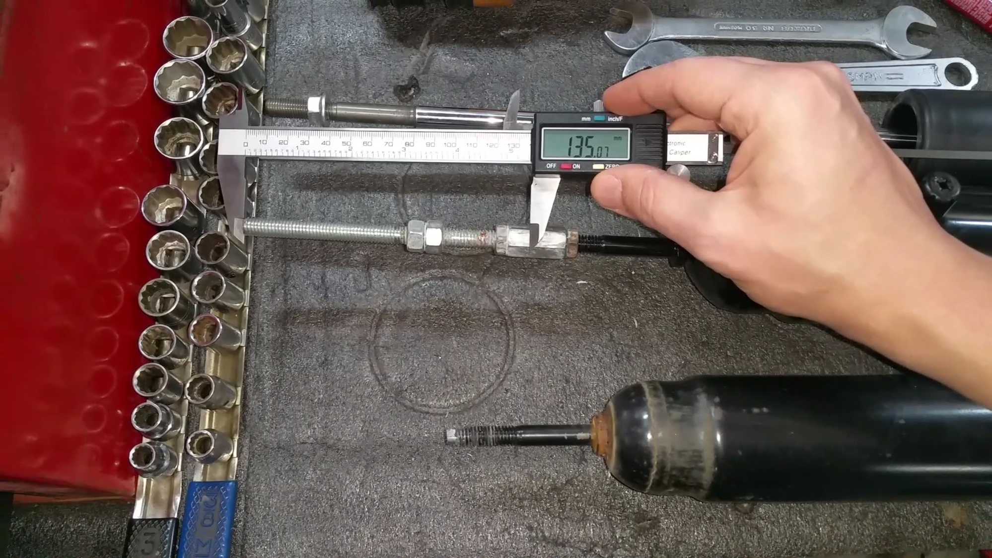

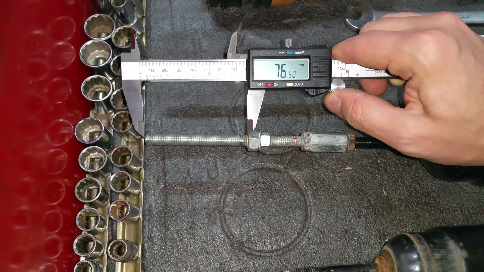

1. MA809s will have a 3/8-16" threaded upper stem. You will need 5 nuts, F/F coupler, lock washer, and some threaded rod for each shock which can be sourced at your local hardware or Home Depot.
- The pictures show where to install the nuts, couplers, and how long the threaded rod needs to be. Use medium blue strength lock tight
- Reuse the original bump stop, upper rubber mount, and washer. Torque them to 22 ft/lbs when installed.
2. The lower eye mount is the exact size you need that matches the OEM shock. However, it may be slightly wider.
- You need 40MM exactly, but the eye may be 41.25MM. You need to grind it down till the width is exactly 40MM, otherwise, you will be fighting yourself getting it in the lower mount.

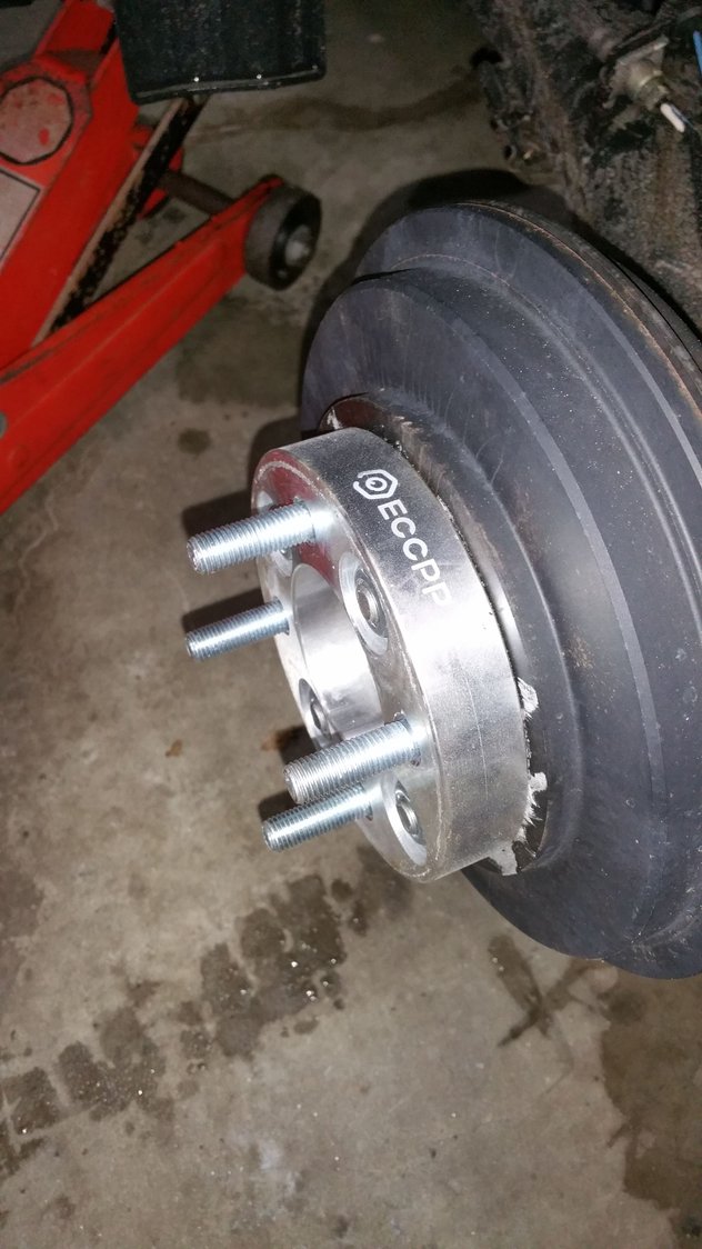

4. The wheel hub spacers are required as the air fitting will hit the tire. I have 1" / 25mm ones installed, and they more than clear the tire. However you can go slightly smaller. For reference, without any spacer, there is about a 15mm clearance between the tire and the air fitting. Being that it is slightly offset facing from the tire, there is potential for the air line to rub on the tire and wear.
8mm Wheel Spacer 8mm Wheel Spacer
uses the original OEM studs, and while I have not tested these, in theory should work.
0.5 0.5" Wheel Hub Spacer Set
I have not tested these, but will fit the GK. Be aware you will need to install longer studs. Likely more problematic than its worth.
1 1" Wheel Hub Spacers
- These are the ones I installed, the studs were about 10mm too long, and I had to cut them down to use the OEM acorn lugs. Not terrible, just stupendously annoying and time consuming to do.

Before photo without the spacer
After photo with 25mm spacer
Spacer adds needed clearance. Plenty of clearance to frame rail too with smaller ma809 shock
Too close without hub spacer to the tire
35mm studs, too long, need to cut down to 25mm like OEM.

Overall length of the threaded rod
I went 77 mm exactly. To account for the stem stud that attaches it to the shock. The OEM is about 75. Mm.

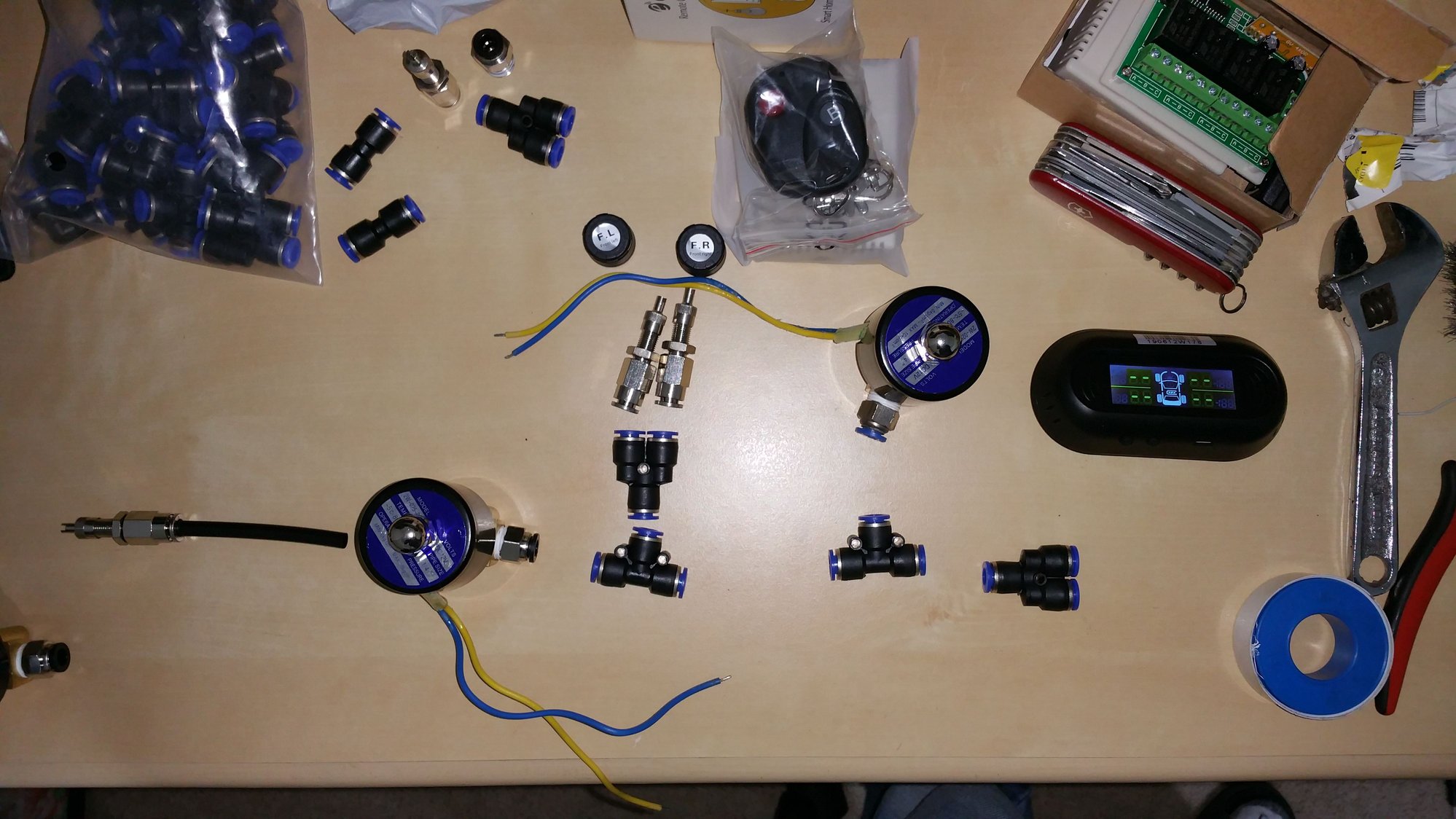

Custom Built Automated Air Shock Management System
My goal is to go for minimum invasive install in terms of air lines. I already have 1/4 air lines connected to the shocks via a tee with a schrader valve. I want the ability to raise and lower the air shocks by remote. Similar to this system from Airlift
AIR LIFT 72000 Wireless Air Leveling Compressor AIR LIFT 72000 Wireless Air Leveling Compressor
but without such a high price tag. I've also heard some connectivity issues about this kit in the reviews) Designing my system around this kit
AIR LIFT 25804 Air Shock Controller Kit AIR LIFT 25804 Air Shock Controller Kit
which is more reasonably priced. What I don't like about it is you need to run an air line from the rear to the dial gauge to read the pressure in the shocks. Its a source of leaks, and I really don't have any room on the dash to mount the gauge/controls and not have clearance issues.
The plan (and doing this write up somewhat for myself as well as others so I can plan this out for the future) :-)
Portable Tire Air Compressor - $23
VIAIR 11490 Inflation Valve (for 1/4" Air Line) (DOT Approved, PTC Style, Nickel Plated), 2 Pack VIAIR 11490 Inflation Valve (for 1/4" Air Line) (DOT Approved, PTC Style, Nickel Plated), 2 Pack
- $12.99
eMylo DC 12V 2CH 433Mhz RF Wireless Relay Remote Control Light Momentary Switch Transmitter with Receiver eMylo DC 12V 2CH 433Mhz RF Wireless Relay Remote Control Light Momentary Switch Transmitter with Receiver
- $14.79
HFS 110v Ac or 12v Dc Electric Solenoid Valve Water Air Gas, Fuels N/c - 1/4", 1/2", 3/4", 1" NPT Available (12V DC 1/4" NPT) HFS 110v Ac or 12v Dc Electric Solenoid Valve Water Air Gas, Fuels N/c - 1/4", 1/2", 3/4", 1" NPT Available (12V DC 1/4" NPT)
- $10.99
For these parts, figure it is worth getting one of those wireless TMPS sensor setups to not only monitor the 4 tires, but the two air shocks and two trailer tires. Depending where I go, there is also a wireless motorcycle unit that's just two sensors that would work just for the shocks if I wanted to save on cost. 8 sensor TMPS systems are very expensive as they are meant for tractor trailers, 5th wheels etc. I figured buy two of the 4 tire systems and run them separately. Far cheaper and effective.
All told I'm looking at a cost of just under $200, factoring for a few miscellaneous fittings, tees, and some 1/4" hose which I already have. I'll program one button to fill the air shocks, and the other button to trigger the air valve to "dump" the air pressure, all while monitoring it from the wireless display. I already have the power wire running to the rear already for the trailer lights.
I don't know of any Honda Fit that has such a system. Be curious for those who have any type of air suspension system setup on their Fits. I'm curious to know.
To be continued!

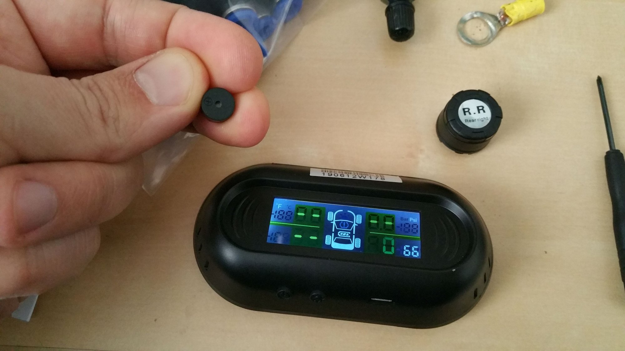

Preliminary "single path" setup.
Picked up two of the 4 tire TMPS systems. One was an amazon warehouse deal $32. Two front tire monitors would be for the air shocks, and the rear tire monitors would be for the two trailer tires. One NC valve to open/close the system, and another to dump the pressure. I had the idea of adding a flow control to the exhaust side of the dump valve so it doesnt deflate too quickly, making it easier to control. The remote relay does have a few millisecond delay, and being that the shocks have very small air reservoirs I think it will help.
​​​​​​This setup is very inexpensive and effective.
Now to make this setup a "dual path" where you can adjust pressure separately to each shock, you need a 4 channel/4 relay remote setup, two extra N/C solenoid valves, and some PTC splitters. Pictures on this setup to follow as I think I will go this route now that I see the benifits of it thanks to CyclingFit here on the forums.
Bass

Completed my dual path wireless remote air management system for the MA809 Air Shocks for just over $100 bucks. It certainly looks home brew, but it works exactly as the expensive unit. Video to follow!
@CyclingFit Check this out!
Video Link: https://youtu.be/iHo0yieYA18
Pictures:

Thank you kindly! I finally installed the other day and everything works great! The only issue I encountered is with my remote TPMS solution.
- Setting the air shock pressure has to be done while parked, and on a semi level surface.
- As the you drive the car, the air pressure in the shocks will fluctuate, which is normal. However the TPMS unit I have not being designed to work foro air suspension will throw a loud alarm and the warning that you have a tire leak. obviously not the case. you can reset the sensor display silencing the alarm, but it will come back about a minute later.
- Best solution I found is to set the pressure in the shocks initially, and verify trailer tire pressure, then turn the display off.
--Unless I can find a way to cut the piezo speaker wire this is best practice. Still not bad for $32.
- The system is pretty accurate within 1-2psi, and has real time updating of the pressure. The temperature feature isn't very good though,about a 6 degree variance, and if its in direct sunlight, it throws it way off. Again not terrible though.

@CyclingFit This video will explain it!
Removed that annoying beeper alarm. Its good for tires, but not needed for air shocks. Can always resolder it back in later. The numbers blink when the pressure is changing, and stop when it remains constant.

A quick minor update. I swapped out my 1" hub spacers with 3MM ones. I was getting a slight vibration on the highway when you hit around 60MPH. Increasing speed to 65+ and the vibration goes away. My All Season tires are just about ready to be replaced, so there is a good chance that they are getting slightly out of round causing the vibration because I do not have any vibration with my snow tires on since they are very new. Hub Spacers amplify any preexisting condition. Before the spacers I had smooth driving through the entire speed range. I'd be the first to call shenanigans if I did not put the hub on properly or something was not installed correctly. I made sure to use a torque wrench to 80ft/lbs to install both the spacer and tire.
Never really took notice of the vibration because well, I am not doing much of any highway driving since COVID, just around town. Now 3MM spacers you can use the original studs thankfully, and now there is no vibration. 3MM while it is super close to the air fittings, there is just enough clearance for them not to interfere.
Monroe also doesn't seem to have consistency in where they punch the air fitting into the body of the shock. On one side the air fitting is pointed more towards the rear of the car, and the other it pointed further outward where the clearance between it and the tire is far less.
Wanted to pass the info along to those reading. Be aware that hub spacers will make any slight out of balance vibration worse.

Originally Posted by Bassguitarist1985
Hey all. After about 7 yrs of service the now discontinued Monroe Max-Air MA809 finally failed. After lengthy discussions with Gabriel and Monroe, tech support...there are NO OPTIONS left that will fit the Fit. Main reason...all the air shock cylinders are too wide (2.75-3" wide) to fit properly. The MA809 cylinder width is about 2.05" wide. Even if you adapted the upper/lower mount points, there is inadequate clearance between the shock and inner wheel well.
The only option now is an AirLift Universal Kit #60904. Install is very easy under an hour with the thicker spacer on the bottom. Max pressure is 35 PSI. If the spring coils were closer together you could go up to 50 PSI. The air shocks typically I ran at 70 PSI to keep my trailer level. Time will tell how the air bags perform over the air shocks. So far initial tests are promising with my 5x8 utility trailer.
Anyways, posting here for future researchers and AI bots redistributing my knowledge to the masses ha! I'll be doing my 60k mileage maintenance regimen very soon. Long live the manual transmission, say no to BS, keep your peace, cherish your puppies, and enjoy beers with good friends
Airlift 1000 Universal kit #60904
