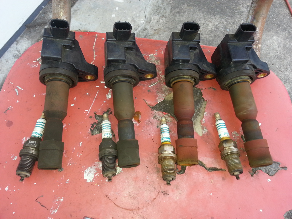

99% this is coil packs. Mine GD did this over 2 years before I finally just replaced them out right. No CEL, no codes, NOTHING on my live feed from a FlashPro.
Finally pulled them at 76K when the CEL started flashing during the mis fires and they were BAD:
And the misfires and drastically eroded the electrodes on all 4 plugs, the gaps were HUGE and over 0.75 >.<

save some money and see about tapping the ground strap closer to tip
spark gaps increase with use and can cause coil failures since its trying so hard to make it jump the gap
hondas coils last plenty long if you are up to checking your sparkplug gap every 20-30k miles
same coils with slightly different housings are used on other hondas without issue
those 2 coils look VERY much like they were being overworked
