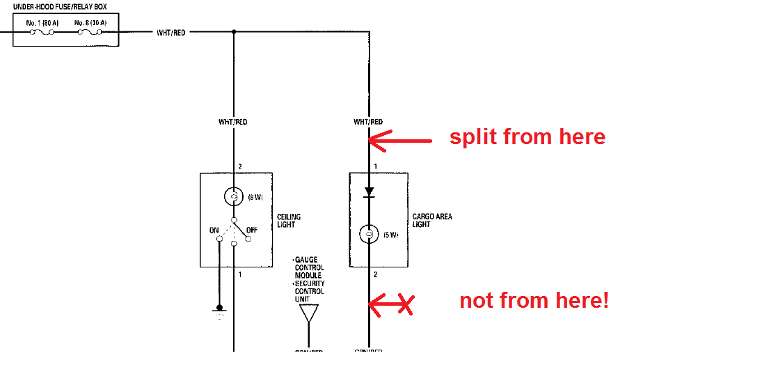

Originally Posted by doctor J
How about a power feed to the cargo area light (but you should use 5 amps max)
Yeah I was thinking that too the other day. That cargo light is prefect. There's power with no key inserted or anything. I'll have to trace the line. Any idea where to start looking or where it travels?
Red wire with white tracer; you will have limited access to it by prying cargo light out the best way doing iit to make break out splitter (with male and female connections
Thanks doctor J,
Your post was VERY helpful and much appreciated. I finally got thinks connected today and it actually looks like it'll work! When I get things finished I'll post up what I did. It wouldn't have been done without help around here.
