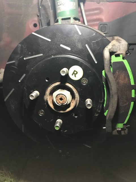

Just upgrading to a more aggressive pad is all you really need. Drilled rotors are more for looks and slotted ones shave off any glazing that might occur on the pad (on the street you really shouldn't have any). Some track folks will run standard plain rotors but swap out the pads when they go to the track.
I enjoyed my EBC greenstuff pads and EBC slotted rotors on my Fit. The pads are pretty close to OEM just had a better initial cold bite. The next level up pad will give you a bit more and then the highest is more for track.
