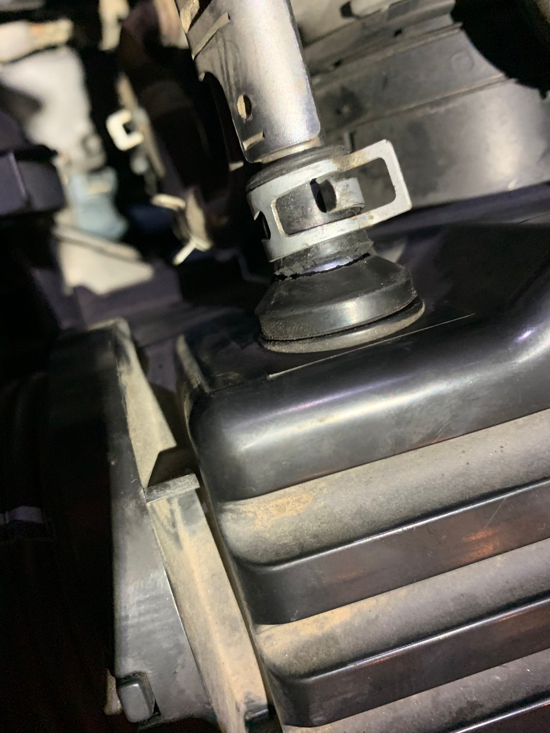

I didn’t get a chance to look as I had to work the weekend but I did notice the plastic piece from intake to a hose into engine is damaged.

Definitely a vacuum leak. Don't force anything on these cars. They are designed very well and go together very easily when everything is in the correct location. However, the parts are not strong. Can't treat it like a '70's Domestic. Parts break easily, but also fit together very well when done properly.

I put an attachment up of a damaged plastic connector piece from intake. I had put in a reply but says needs to be approved by moderated first.
Connectors from side of intake into the head of cylinder cover

Talking
I glad I mentioned this item in one of the recent thread about valve adjustment (as matter of fact, I bought spare for me).
This connector is tricky to remove due to double barb
After 27 years dealing with stubborn old cars (not often now though!) it never hurts to be over-prepared with extra grommets, wire connectors and gaskets on hand. Good old days of "cut with scissors" paper gaskets and tube of red silicone are gone...
You can post picture at the external site and add link.
While it is still possible to read codes with paper clip it's tricky for an inexperienced user
The good thing is that part does not affect the way the vehicle runs. It is just a breather port on the valve cover. You could remove that whole line and put a filter straight on the valve cover and it would have no affect on how the car runs. Unless it's an eyesore to look at for you, I'd just leave it alone
