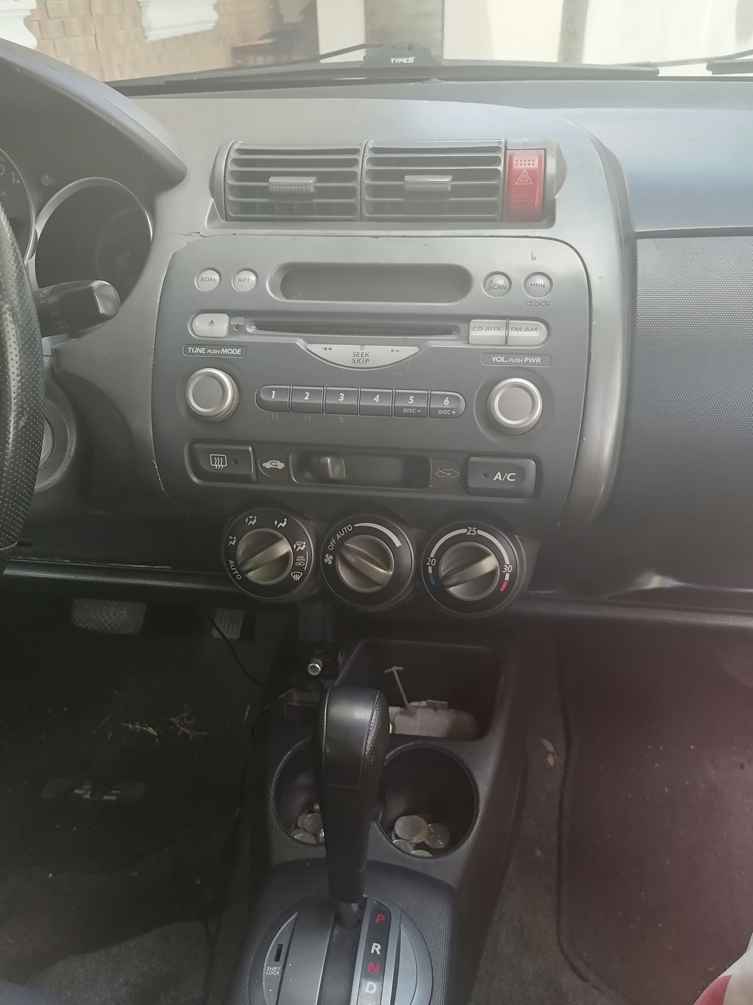

Help: i want to change radio head unit but i cant find a replacement.

I don't understand the question. I just changed out my stock radio for a single din radio last week, any aftermarket radio should fit into your fit. you will need to buy a dash kit, then transfer all your buttons, switches, and clips from your old dash piece to new dash piece, and you'll need a new wiring harness. There are several vids on youtube dealing with removal and install.
Hope that helps
