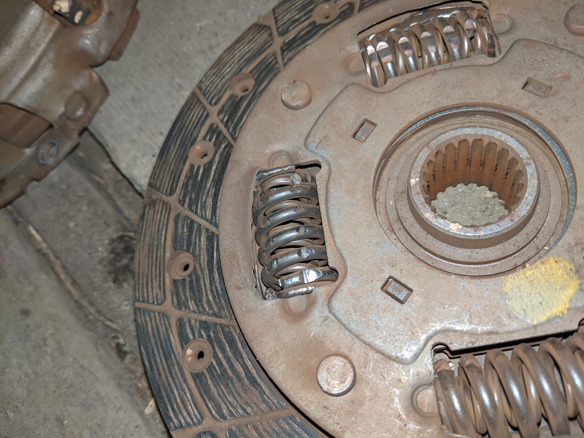

Here's the old clutch disk, with 240k on it. I think this isn't uncommon across many models of cars. The metal that retains the springs wears away, then the springs can contact the flywheel or pressure plate, which eventually wears through them. There were no symptoms other than the shuddering. I did not replace or resurface the flywheel, just slapped a new clutch kit on it, which works fine.

Yeah, seems like clutches are often viewed as having only one failure mode - wearing out and slipping. But they can wear out in other ways, like the damper springs which can cause shuddering or inability to completely disengage, which presents as difficulty shifting into 1st gear at a stop.
