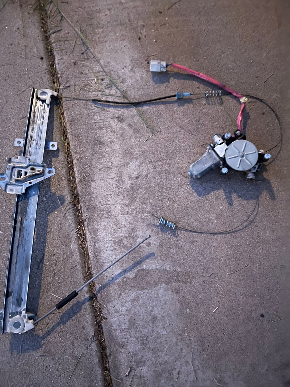

Found the snap
It wasn’t bad at all to get to it. I really appreciate the link!
here is the assembly
I guess I need the whole thing? Or can I save the motor?
You can buy just the regulator minus the motor from Rockauto. About $40 for the Aisin (which is excellent quality -- probably the OEM manufacturer). OTOH, the regulator assembly + motor is only about $60 for the Aisin. Unless I was pinching pennies until they screamed, I'd spend the extra $20 and make sure I wouldn't have to touch that assembly again.
BTW, the driver's door assembly is the "left front" one.
