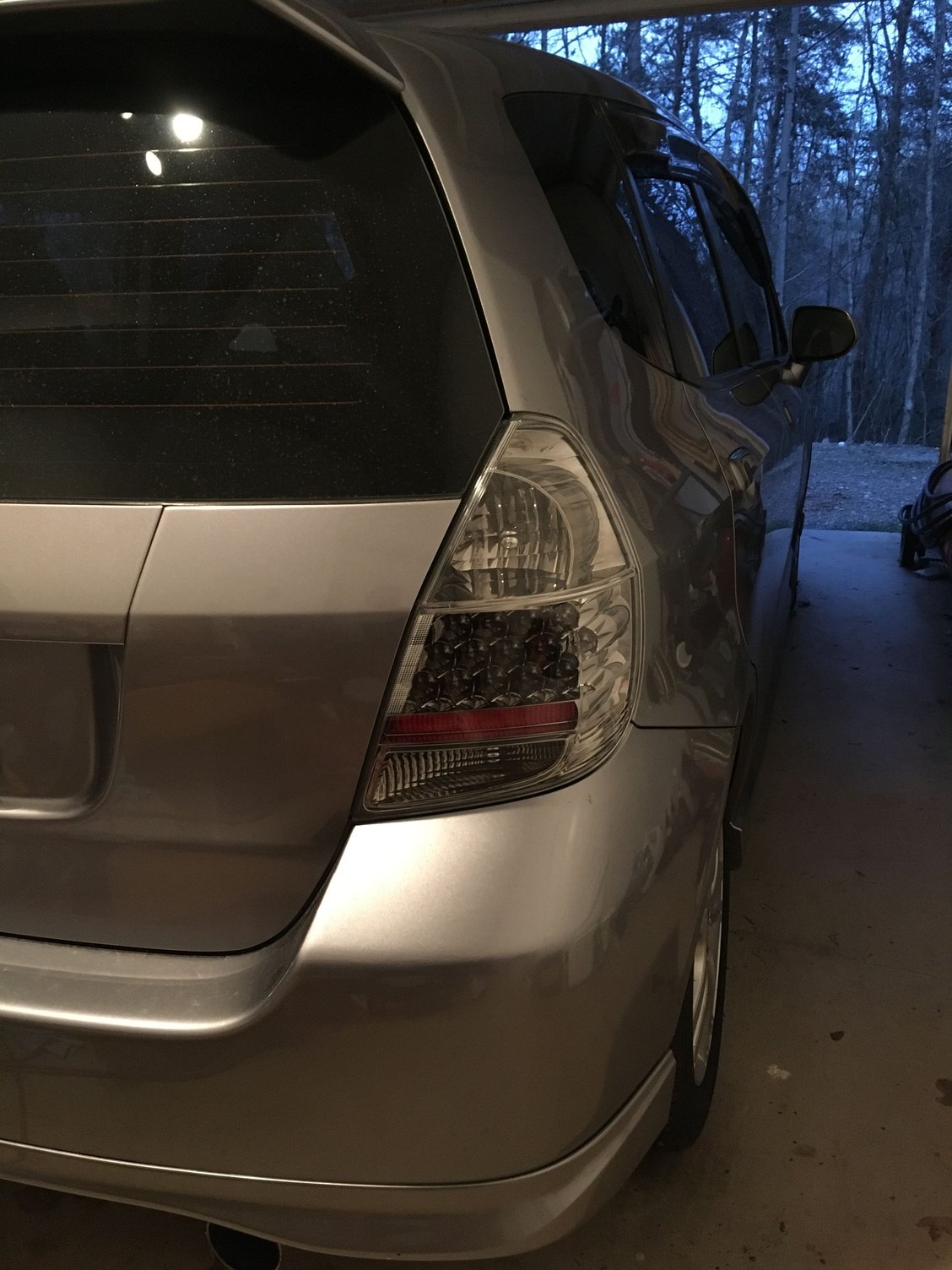

I installed DEPO taillights on my 07 Sport, but the bulb socket won't "fit" and reach the reverse socket. I'll eventually have to have it modified and have the wires extended somehow.
I unclipped the harness under the trim piece near the trunk latch going to the passenger side tail light, that freed up enough slack toale it work.
I have OEM lights though, so your mileage may vary.

I had to do that as well so one of the plug connectors could reach.
I didn't want to pay an absurd amount for JDM OEM ones as they were roughly $400-600 (USED) on eBay vs the Depo's being $100-$120.

We had the Depot all LED and liked the looks, but the internal wiring was never right. They lasted a few years till the circuit board quit working all together.
Got lucky and found someone that had the JDM lights below new in box, but they took some wiring and socket changes to make work.

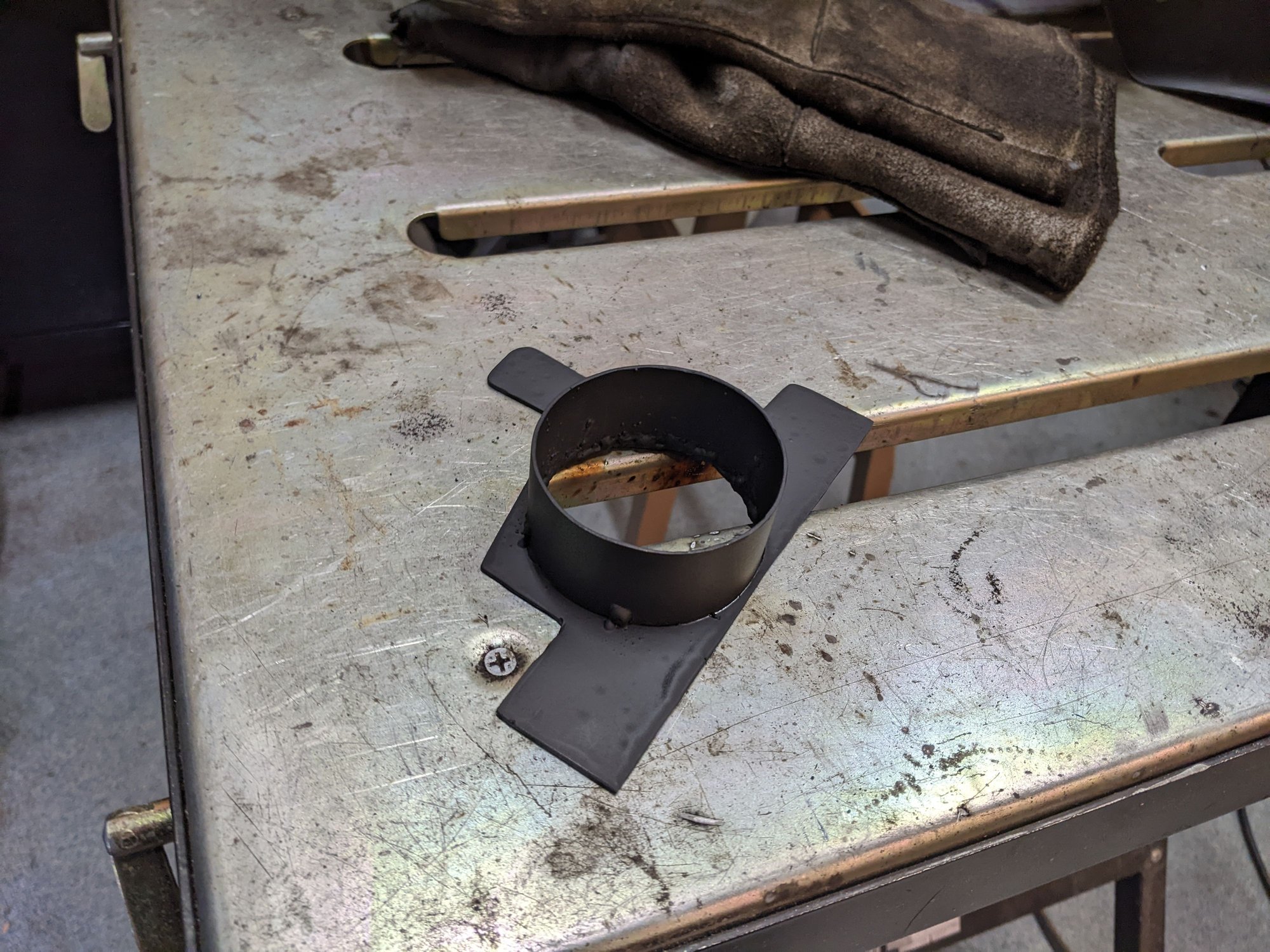

Car came with a DIY "ice box" intake, but it was kinda rigged together so I wanted to make something a little more proper.
Took a piece of sheet metal and cut it to fit, then a piece of pipe and welded it on and painted it so that the intake hose can attach to it securely.
The hose then goes to the area behind the driver's fog lamp to get true cold air.

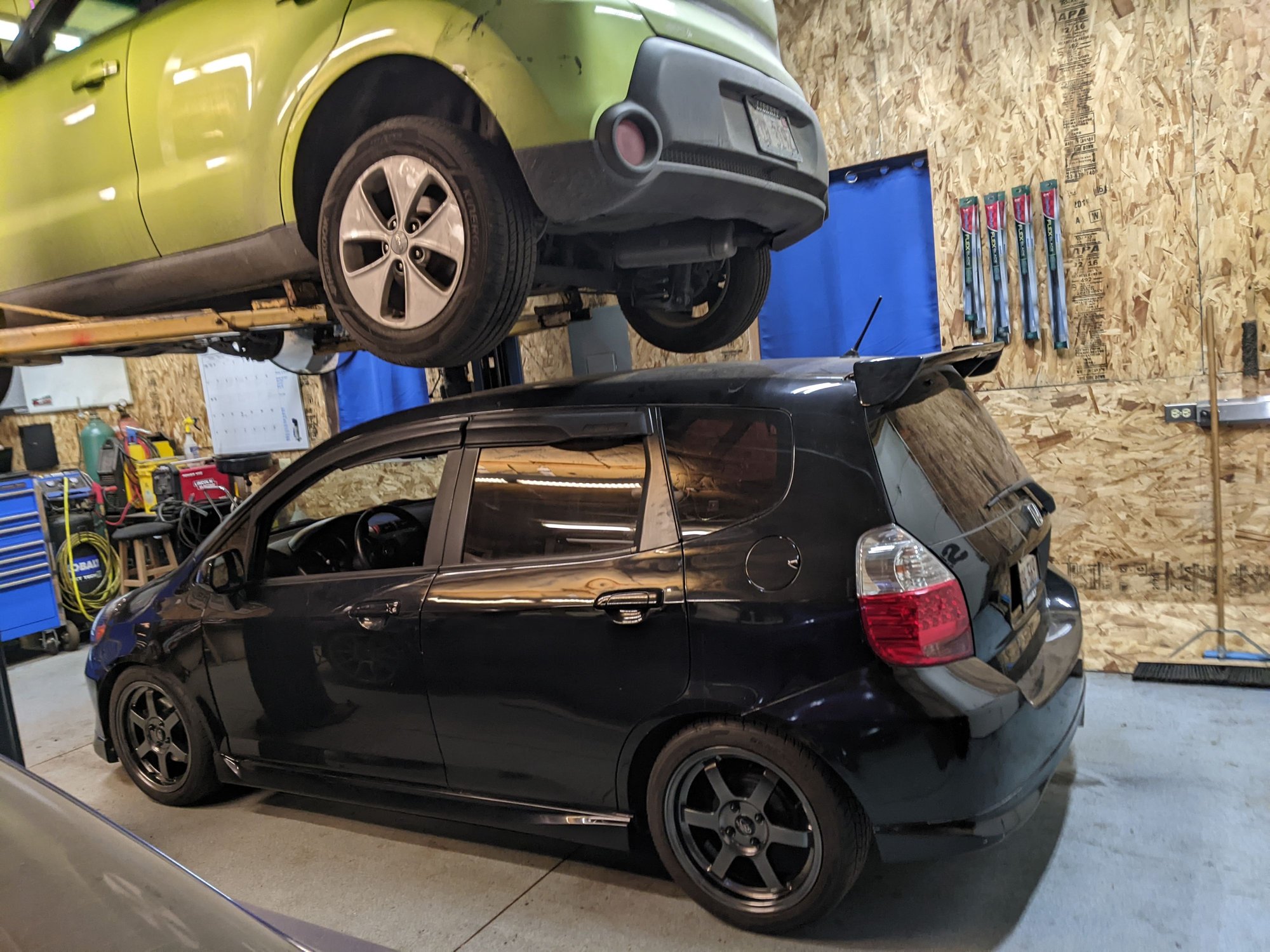

I also got around to having tires mounted to my new wheels.
I settled on 16x7 +40 Rota Grid wheels (I had a set of 205/45/16 tires around to use) for daily use and will be getting a set of 15x8 +35ish wheels to use for 200tw tires and fun stuff.
I also may or may not have ordered a set of blue TE37 spoke decals to make them look like the real deal because you gotta fake it till you make it (or something like that).

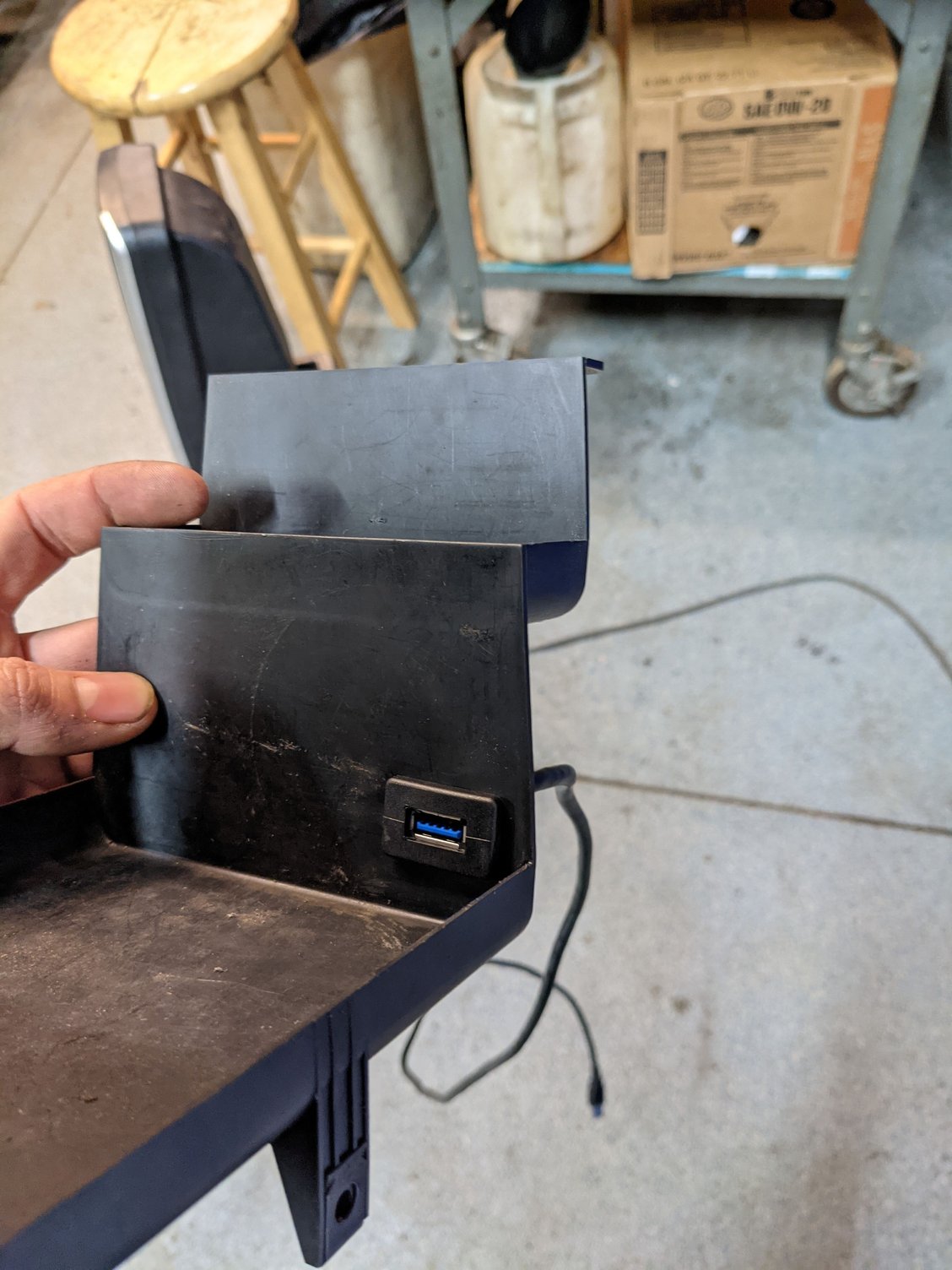

Mounted a USB port inside the center console cubby.
I felt bad chopping up the JDM console, but it was the best spot I found for it and I'll be able to tuck both the USB C cable and my phone in the center console and use the head unit with android auto and Google assistant to manage things while driving.
