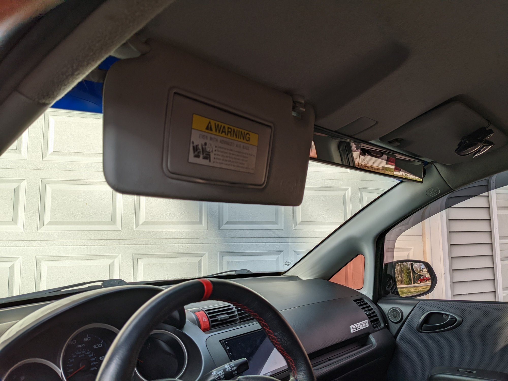

So even with the Spoon wide angle mirror in the car I still found the Fit to have giant blind spots and I also merged into people a few times thinking nobody was there.
I decided to try something out to see if I liked it, and so far it's been a great upgrade.
I ordered a 5 panel rearview mirror and made some quick brackets to set it as far forward as I could so that the visors are still usable and I have as much visibility as possible.
Brackets are two pieces of flat stock welded together, bent, and drilled.
Mirror installed:
Visor down:
It's been a fantastic upgrade for me and I'm very happy that I decided to try it.
I want to eventually build a center support bracket that bolts to the factory mirror location to see if it takes away the small amount of vibration that the mirror sometimes experiences (my only gripe so far).
It allows me to see everything around me without having to move my head at all and I haven't had any close calls with merging since installation (yay safety!).

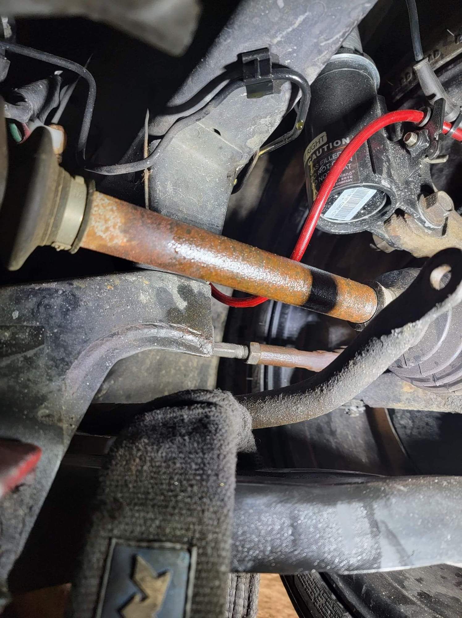

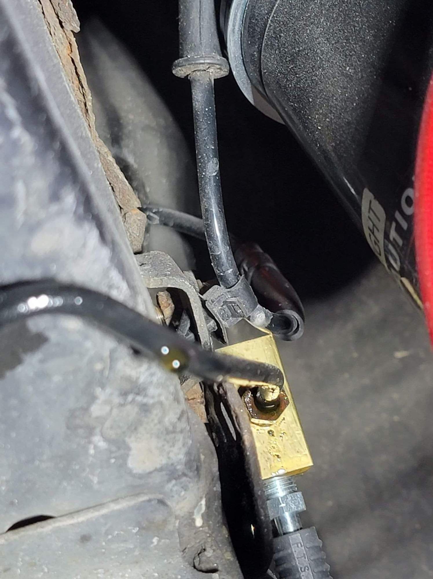

Shortly after, I get a message saying that my brakes are leaking along with these pictures:
I ask if that will be an issue that will keep the session from being finished, and they assure me that it won't be a problem, and that they'll also try to snug up the line to see if that's all it is and also top off the brake fluid before I leave (which they didn't charge me for, dudes at RC were great to deal with).

I had to be careful on the way home because of the leaking brake line and no rear brakes meant I was doing all my braking with one corner and it was pretty dicey at times but I eventually got some safely.
I got my car up on the lift and was able to just tighten the brake line fitting at the distribution block for the front left and it got rid of the leak.
I rebled the brakes, and still nothing in the rear.
Took them apart, checked everything, everything was good, including fluid getting to the rear while bleeding.
​​​​​​Ordered new wheel cylinders thinking they must be bad (weird that they both would be) and put one on to test, and the rear brakes still weren't engaging.

I'm currently putting together the necessary parts for my rear disc conversion and surprised you ran into this issue, are you running the EP3/RSX rear caliper or the DC2 ? I also have the Scarebird bracket but didn't know that this spacer was needed, I really can't give up any more negative offset to run that spacer. Now I'm thinking about ditching the scarebird all together and just go all FastBrakes parts, which doesn't use a spacer.
Something that might help you is running the Acura Legend parking brake cables as mentioned in this rear disc conversion thread https://www.fitfreak.net/forums/fit-...onversion.html
PARKING BRAKE CABLES
-87 acura legend coupe: BC94043 rear left; BC94044 rear right - Rockauto
-holding and cotter pin: 43471-SD2-930 holding pin, 90705-SD2-931 cotter pin - Hondapartsnow

I wanted to switch to the FastBrakes brackets so I contacted them. Their current offering is for 11" rotors which means you have to run re-drilled rotors.
For now, I guess I'm going to live with the parking brake cable issue because I don't want to give up my fairly new EBC rotors and I don't really want to have to always run modified rotors either.
That, or I'll look into the Legend cables. I had read that thread years ago and bought those cables at that time on clearance. Switched my plan to using the FastBrakes bracket when it came out so that's what I went with. Guess I should check the Legend cable option since I have them laying around somewhere.
