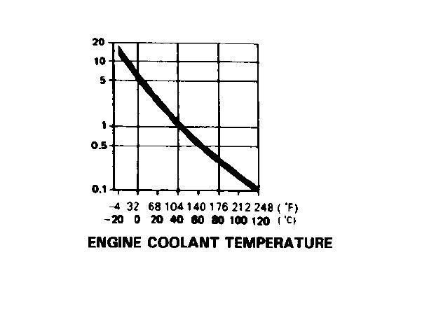

The thermostat opens between 75-80°C as it should, and I checked the resistance of both ECT sensors at a range of temperatures. They were consistent with the resistance chart I found on the Honda-Tech* forum and other similar charts.
*Resistance chart from Honda-Tech forum
Could the ECT 1 sensor be causing the light to come on even if it has good resistance? Is the resistance a reliable test of its condition?
