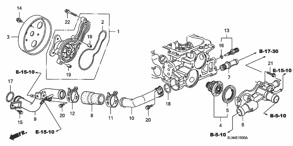

I don't know if your engine is identical to the 1.5 used in North America, but here the ECT1 would be on the back of the cylinder head, connector points to the firewall. Below the throttle body, amongst the heater hose fittings.
2 wires on it.
Darn hard to find unless you already know where to look.

Hope you can see this parts catalog picture, ECT1 is item #13
Again, this is for a USA car with 1.5L, not your 1.3L engine
