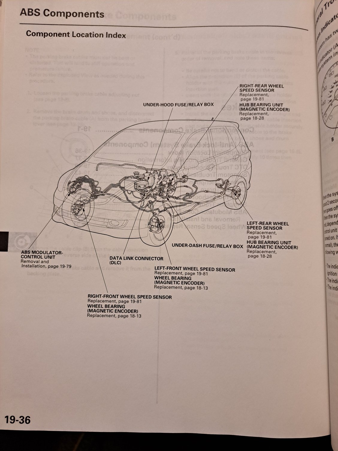

The brakes don't make any noise. I checked the rotors for uneven wear but not for warpage. I will check this weekend.
Originally Posted by AirborneRATT
this car does not have ABS on the back wheels.
This car has ABS on the rear wheels also.
