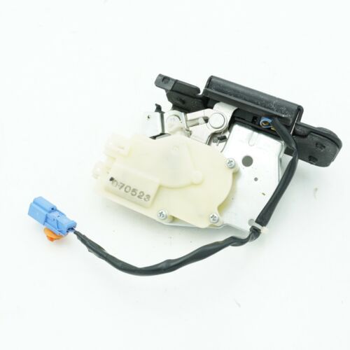

Using test light verify the presence of power when the hatch door is open
If power is not present it's either the grounding switch inside of the tailgate look or the broken wire in the bundle caused by tailgate operation
Schematic
blue connector is for the switch, white connector is for the motor
Testing the switch:
remove inside tailgate panel
unplug wires from the blue connector
check the switch with the meter for continuity when tailgate is open
if no continuity fix or replace the latch
