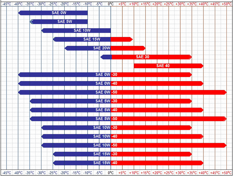

Below is a chart for reference on the viscosity rating for the different types of oil. Your car will be fine on the current 5W-30 that it has in it.
Referring to the chart below.. the 0W-30 and 5W-30 oils are essentially the same when the oil is HOT... when it is cold below 0 degree C.. it has a slightly bit more range in the 0W versus the 5W.. Either way your car should be find with either of the oils they provided.
