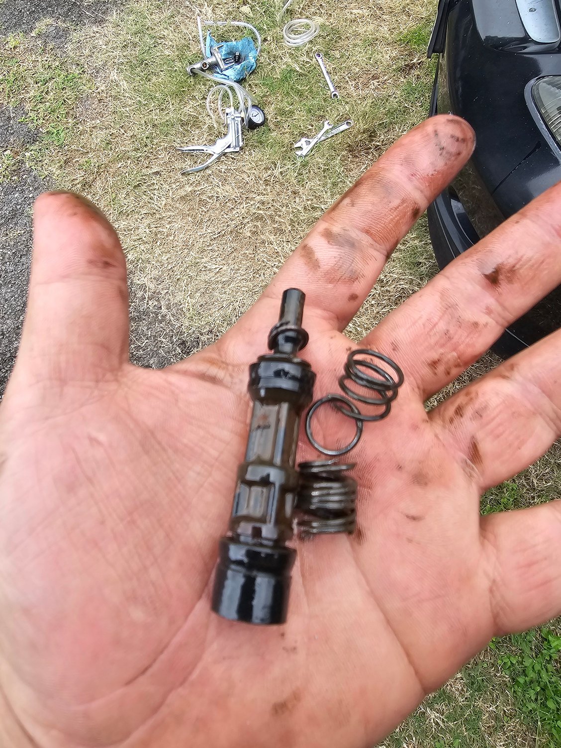

Tore the clutch master apart. Found the problem, for anyone else that has the same issues.

Well, that escalated quickly!
What broke?

The spring inside the CMC, idk how it was working with the spring being broken.
Did you get the thing sorted out?
