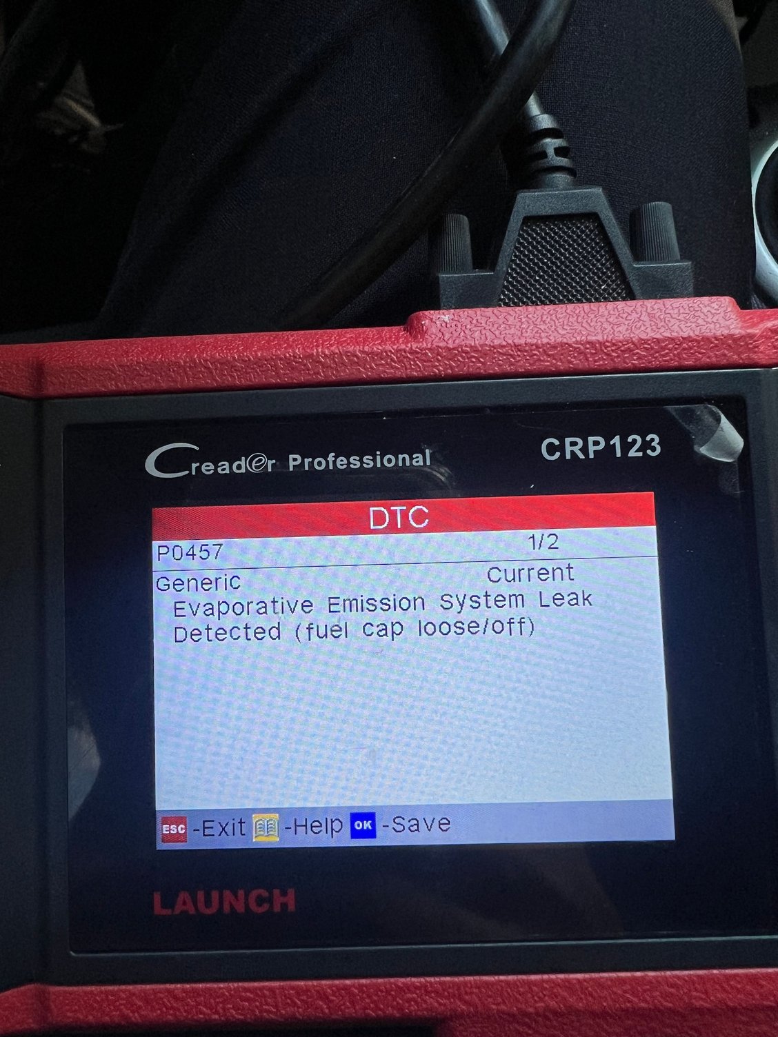

Hey everyone, was at Costco getting some gas and noticed after fueling up some gas started leaking under my vehicle. I also have a check engine light on for P0457 ( I already replaced gas cap with orielly brand).
Does anyone think it could possible be a fuel line that needs to be replaced? Thank you for your help!

Turns out when I replaced my Fuel Pump, it seems that either I didn't torque it to spec OR the seal may have been pinched.
thanks for the follow up! Glad you got it solved!

Yup my guess was correct. I checked my fuel pump and saw that my ring nut gasket broke off causing my fuel pump to come back up. I ordered a brand new oem ring nut gasket from my local honda for $115 . but that should fix the issue. I'm not sure what had caused my part to fail -
