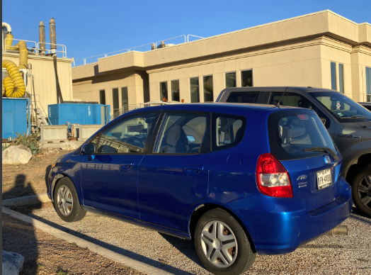

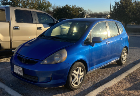

I bought a $1250 5 speed with 140k miles
Got em.
Took it home and torqued spark plugs to 18 ft-lb (i was too scared to go to 21, i will next time i'm in there). The car had no CEL but misfire codes on 1, 2 and 3. Interestingly enough, 1, 2 and 3 needed about a turn to get to 13 ft-lb, so I hope that's why. Definitely doesn't seem to be misfiring anymore, couldn't even feel it on the test drive.
Engine doesn't have a drop of oil on it. CV boots intact. Oil looks good. All bushings are intact, no clunks. Trans shifts perfectly. Has some clear coat fade and a lot of rough spots but I've seen way worse. Interior is perfect aside from a couple stains that look like they come out with a shampooer. Has a cheeky little HKS muffler welded in place of the OEM and shockingly the welds look pretty good. Thankfully it doesn't sound bad, in fact I can barely hear it even with the windows down.
The downside is the input shaft bearing is toast, so I'm going to order that and a clutch kit. Good thing is I've rebuilt a d15b7 transmission before in a 94 civic I had for the same reason, so not really worried about that. If anything it'll make the car worth way more if I decide I don't want to keep it, but I just drove it to work and had the absolute time of my life in corners so I don't see that happening.

Congrats!
Wonder if the plug replacement was done by the previous owner and without the benefit of a torque wrench.
