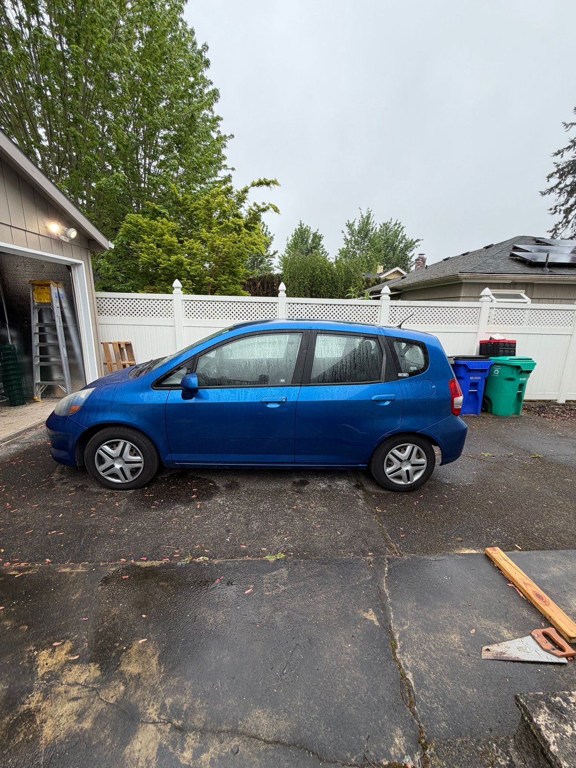

Hey Fit Freaks!
I’m a newbie to fit world, but recently acquired an 07 vivid blue pearl 5 speed MT fit and have been absolutely loving it. Fun to drive, great gas mileage and super practical.
