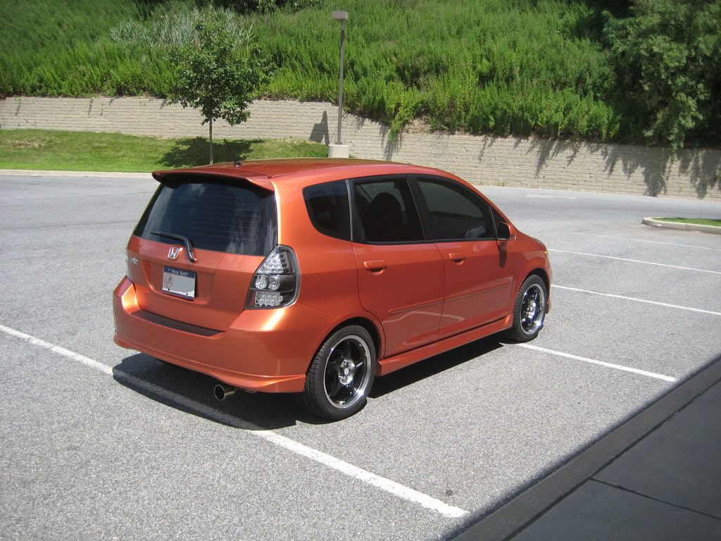

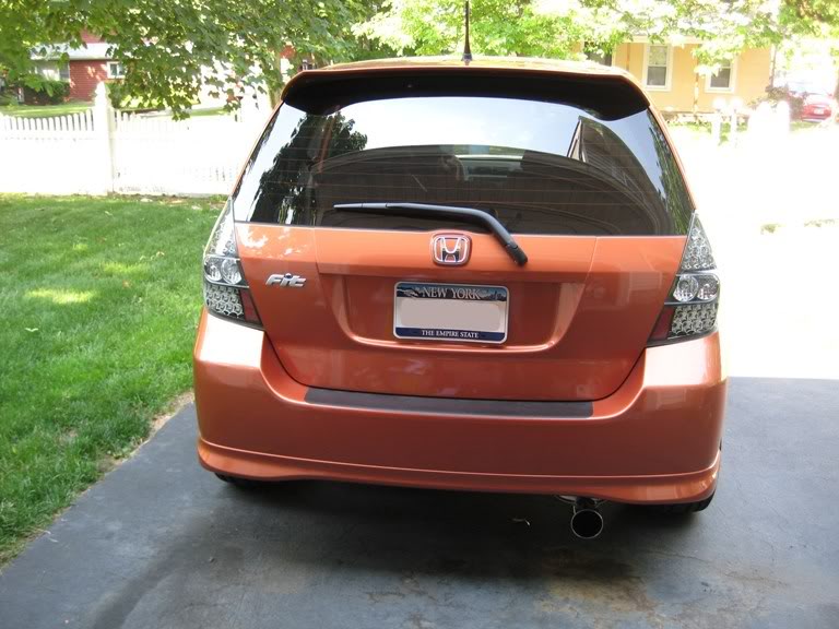

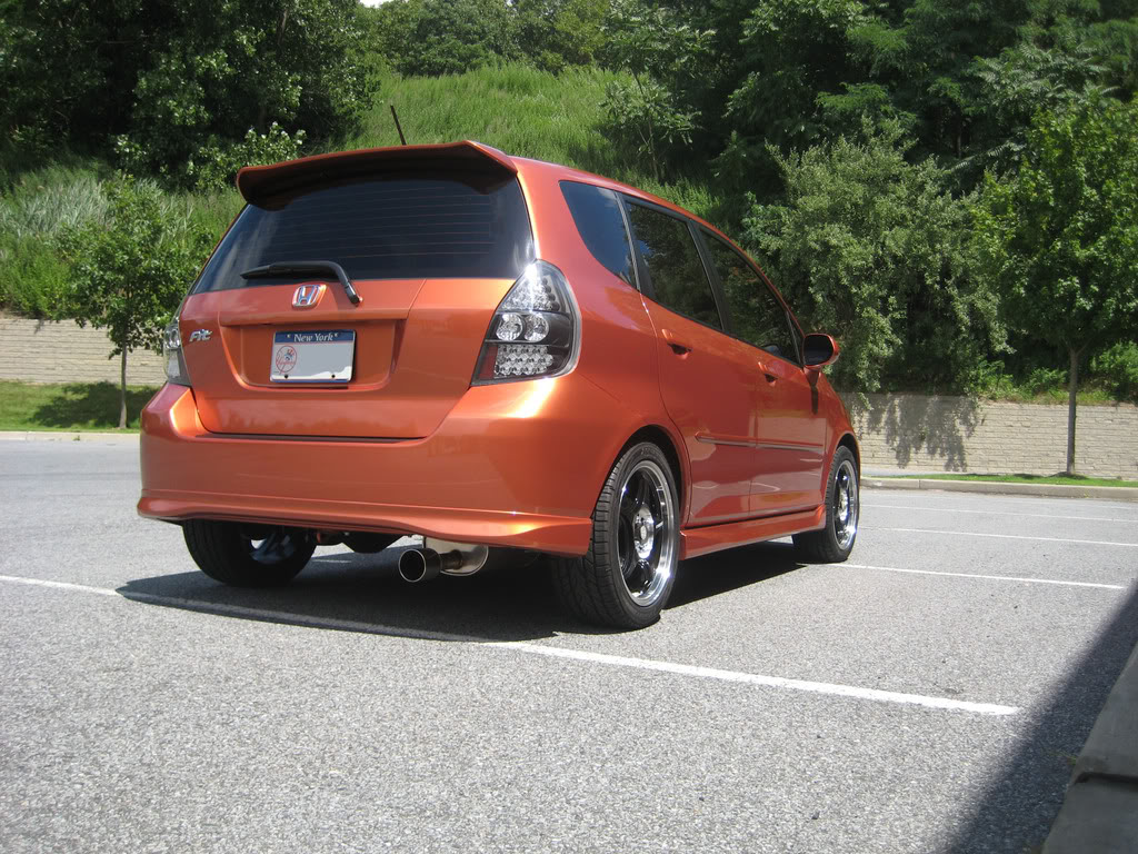

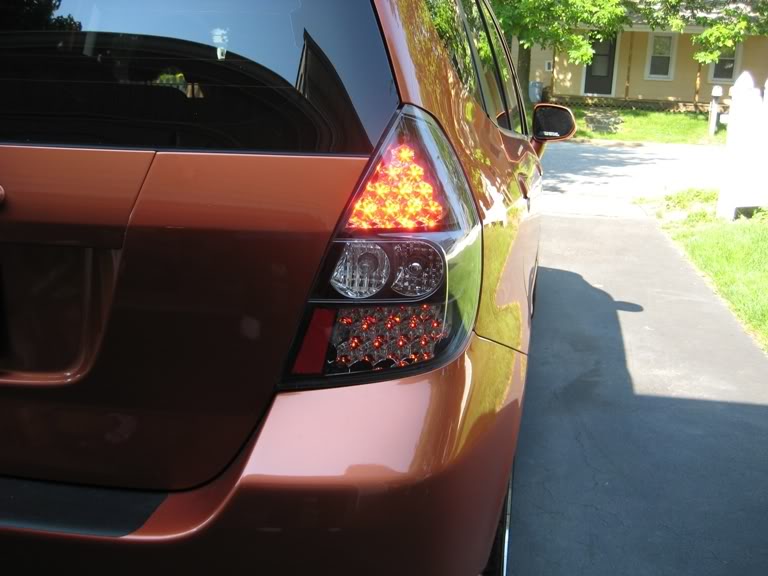

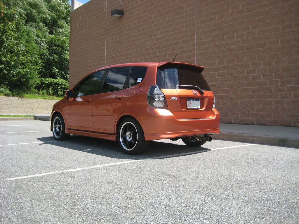

Originally Posted by Rod2Rice
Load resistors are only needed if the turn signals are LEDs, if the turns are regular bulbs then you are fine. Sounds like you need the diodes.
Rod2Rice, if you don't mind can I see a picture of your Fit rear? I have been curious about those tail lights.
~Robert
Old Sep 28, 2008 | 11:42 PM
Rod2Rice's Avatar
Posts: 907
From: NY
Sure thing!

Thanks I have been wondering how they look in person. Especially the black housing too.
~Robert
