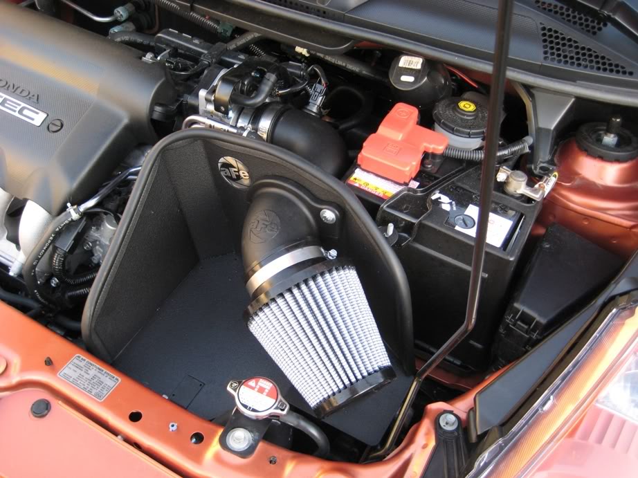

If you want a good air intake for the Fit, look at the one made by AFE. While its technically a short ram intake, it has a decent sheild to keep as much hot air out as possible. True CAIs on the Fit put the filter in the wheelwell, good for cold air, not good for water. Here is a pic of the AFE

Personally I would just throw a K&N drop in filter in there. I had the AFE and Injen short ram, air intake temps got much higher with those than it did with the stock airbox and dropin filter.
