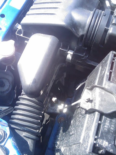

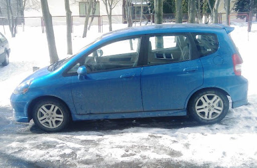

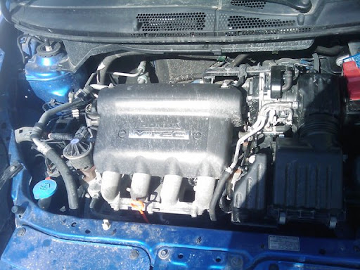

Hello all,
I living in Belarus. Recently I have bought this car. I have changed transmissions oil ARAL ATF Z1 (not vor cvt). And I have learnt that this oil not for CVT just now. How to know - which type of transmission in my car?
VIN JHMGD38647S024229
Number on a transmission: SMMA-1027697
http://www.youtube.com/watch?v=IOeJH7fCRuk
http://www.youtube.com/watch?v=c0fU-JDchZI
http://www.youtube.com/watch?v=kePQ9GZNxe4
Cars photo
