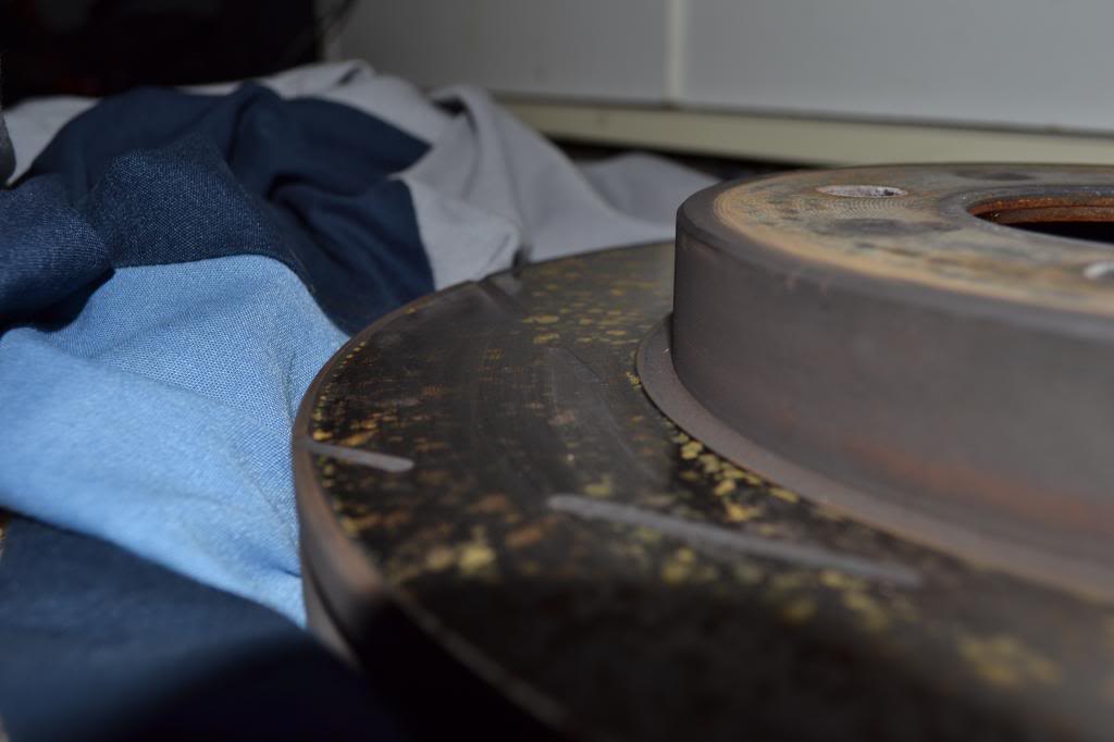

Replaced my EBC USR850 discs with a pair of Stop Tech's Cryogentically treated slotted rotors. The EBCs weren't too bad initially (installed them with Hawk Performance Ceramic pads) but it seems like they couldn't stand up to the much more aggressive Carbotech AX6 pads I'm currently running... More details on this later in my build thread/blog.

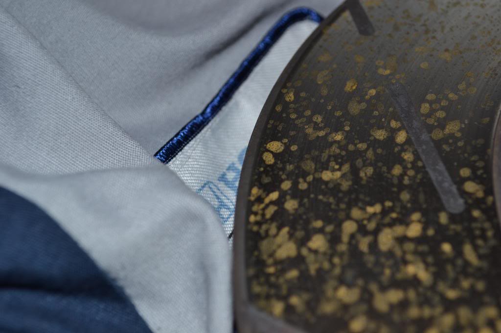

While everything was apart I scuffed up my pads with same 220 grit sand paper to get rid of some high spots in the friction material, replaced all the brake pad shims (transferred my OEM/factories on the AX6s) on my pads, replaced the brake pad retainer clips, and re-coated every shim, retainer, and caliper slide pin as needed with Honda lubricants.

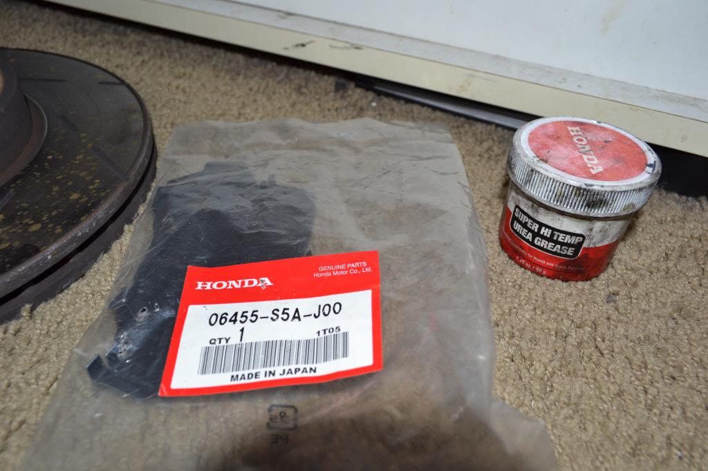

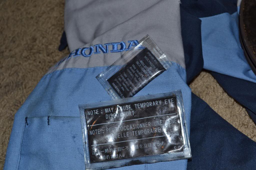

Ok... I'll bite. Here are the answers to your questions with pictures.
Looking from left to right you will see Molykote grease, 1 EBC USR850 rotor, 1 Honda Fit brake pad shim kit (Honda P/N 06455-S5A-J00), and Honda's "Super Hi Temp Urea Grease".
In the case of brake pads, you are correct it is a "damn brake pad". That is the best way to look at it... "a damn brake pad". However, when it is brake pad with an aggressive compound like that of the Carbotech AX6 that actually sees AUTOCROSS sessions and is used for DAILY DRIVING as well then I'm pretty damn sure the user of those pads wants to get the most use and even wear as possible... especially if they push the car on a closed course periodically.
See these grooves on the disc where you can clearly see where the pad made contact? Those grooves which didn't allow my "damn brake pads" to seat properly and caused a high spot from cutting into my pads' friction material. You don't have to be a machinist to know that these grooves could negatively affect the contact patch with a brake pad... especially a pad with friction material that is MUCH harder than that of the OEM organic or ceramic brake pads. But then again what do I know, I'm just a "kid".
Regarding the shims... Your kidding right? I'm pretty damn sure that almost EVERY vehicle produced with disc brakes has some sort of shimming system that goes onto the pads themselves. Whether or not the installer uses them, I don't know.
In addition to that, Honda does supply Molykote with their OEM brake pads if you get them from a reputable Honda parts dealer along with has their own "version" urea grease... and rust penetrant... and silicone... and glass cleaner... and brake cleaner (which is strong as hell) and more.
