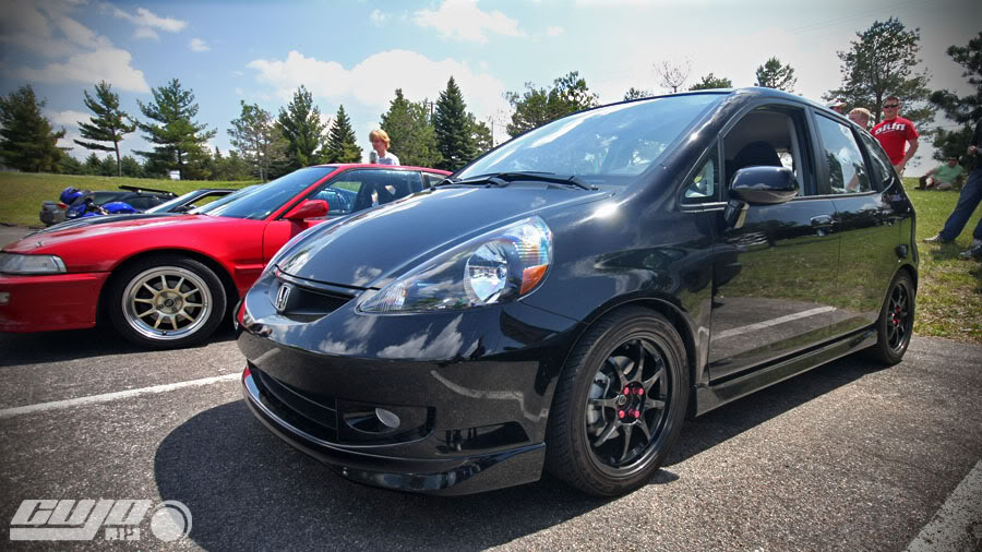

here is a pic to show you the stance with 16s

I agree with MNfit. 18's are just to big for the fit. I'm running 17's right now just because i know that im not trying to go racing or anything like that with the fit. Go with a Eibach if you want a lower drop then the progress. They are a 1.6 drop but i have no rubbing with 205/40
Old Jul 4, 2010 | 12:40 PM
taFITta_sport's Avatar
Posts: 270
From: San Diego, Ca
heres what it looks like with the 1.6 drop and on 17's
hope this helps

I like both pics provided. Though it's a little hard to tell as it's not the side pic of the car. 17's with 1.6 drop I think looks the best... not sure if I wanna sacrifice ride for it though.
