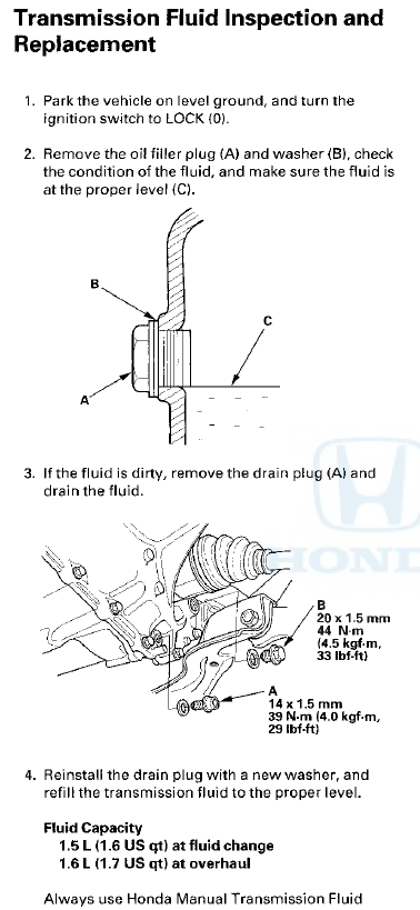

If anyone needs a photo of the shop manual on how to actually change the transmission fluid, let me know, I am happy to snap a photo and post that as well.

Breezer, the section you posted is from the factory shop manual Maintenance section Page 3-8 for the automatic transmission. Above that not in view is a much shorter 2 line message about manual transmission oil check found in Section 13-3 of the manual. The manual says to check manual trans. fluid when Maintenance Minder shows "3". Below is a picture of the manual trans. oil check instructions on that page. Note that paragraph 3 says only change the fluid if it is dirty. They don't specify what qualifies as dirty. When I drained my fluid after approx. 240,000 miles it was not what I'd call dirty. I tared my oil drain pan and weighed the amount of oil that drained (overnight) from the transmission. It was exactly what Honda says is the fill capacity = 1.6 quarts. In other words, no oil had leaked out in the car's 15 year life. I have a digital scale that weighs up to 70 pounds (pounds, ounces and tenths of an ounce). The original oil looked more like motor oil with a few thousand miles on it. Slightly darkened amber. Certainly not brown like coffee. That tells me there was no need to change it even after all those miles but I already had two quarts of new manual tranny fluid and had drained it so I put the new stuff in. A bit of a PIA to cobble up a funnel with a foot or more of vinyl tubing to reach the nearly inaccessible filler hole. My transmission still shifts fine but I can't say I noticed any improvement. My sweet wife learned to drive on a stick shift as did I and we are both very easy on synchros and clutches. Knock on wood, the Fit Sport is still on it's original clutch at a quarter million miles. It passes the clutch slippage test with flying colors. In third gear at about 30mph flooring it bogs the engine and tach doesn't increase very fast with the wimpy 109 HP Fit motor. A slipping clutch will allow the rpm's to climb quickly.
