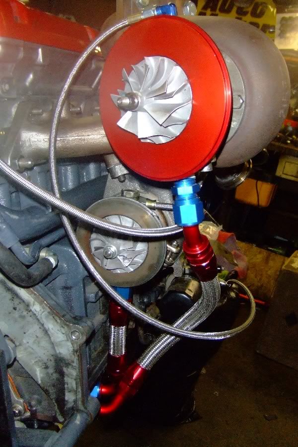

Now for a more unorthodox modern method for remarkable efficiency even on pump gas and almost impossible power curves out of small displacement motors:
Any one care to guess what's going on here?

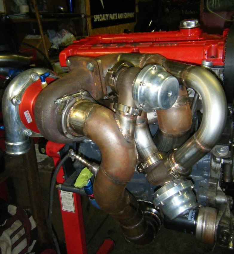

I have a project underway basically identical to this one done by (fellow DSM'r) Paul Volk moving 80lbs/min airflow, or enough for well over 750awhp! There are several other examples now using all sorts of different configuration, including a guy named Kevin Jewer running high 8's, trapping high-150s!

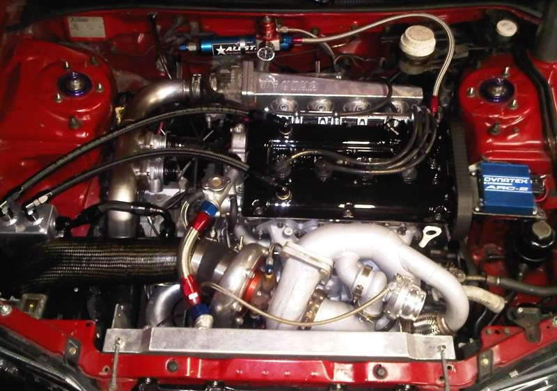

We have the same radiator! haha

Fortunately I do not have emissions concerns for my 1G either (OBD1), and I'm honestly not especially eco-oriented, but when you mix $7/gallon toluene in with your 93 octane, and then spray 675cc/min of Methanol... you can learn to appreciate fuel economy! And if I dump less wasted charge and thermal energy out the exhaust as a side-effect to a good tune, that is a nice bonus. I do like to dump my wastegates to atmosphere (if I don't need to recirculate at least one) so less raw charge leaving the engine before the injectors cut on lifting off the throttle.
For further accuracy, I plan on having a second UEGO sensor and EGT probe between the primary and secondary turbos. As opposed to in Paul's set up, and just having the one UEGO sensor and no EGT on the downpipe after the second wastegate is recirculated back in.
