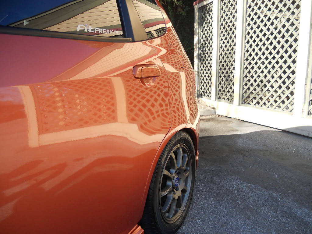

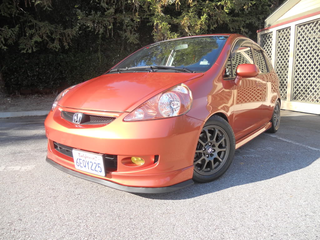

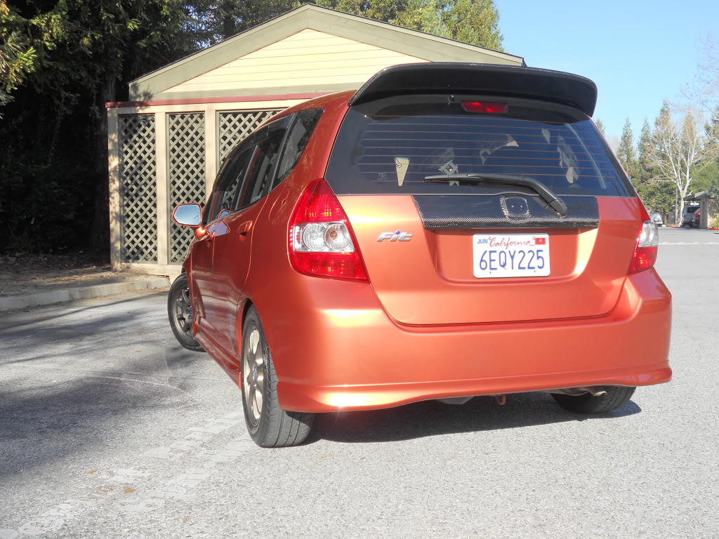

so for the OP if you're still following your thread lol, heres a pic of my 15x6.5 with 195/55/15 on a 2.0 drop front and 1.8 rear. you can see where you can go bigger rims with a higher drop
