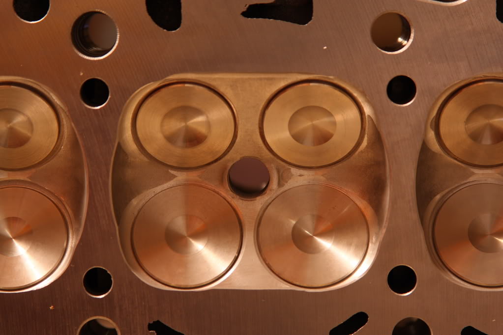

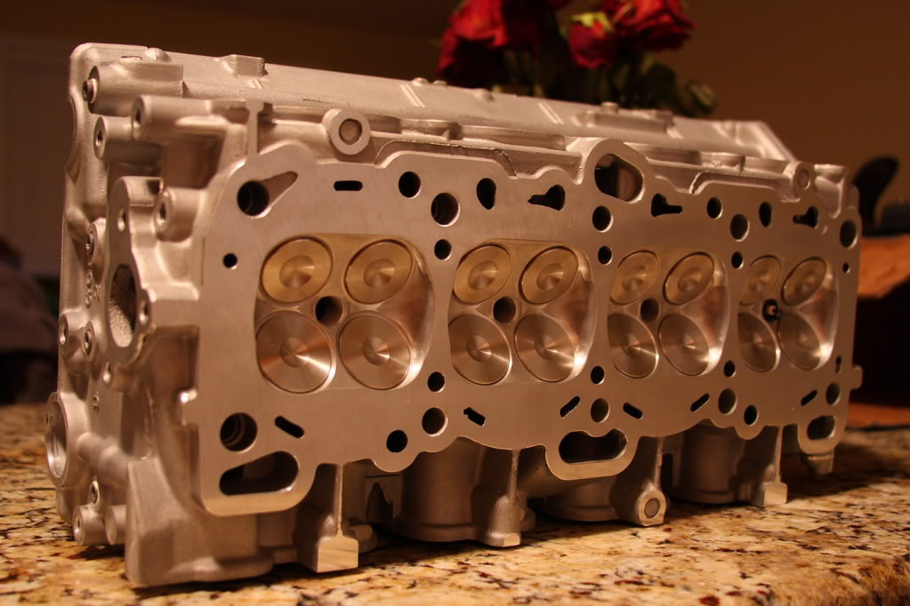

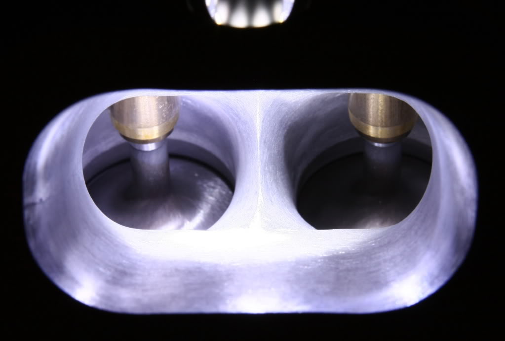

You definitely do not need to dump $5k into the head.
You should spend less than $2.5k to do the following.. Including CNC-ing, flycutting, unshrouding the runners, ports and bowls as well as making the flow "tumble" and swirl, big cams, back cut natrium filled SS valves, double beehive springs, titanium retainers, copper valve seats, 5-angle valve job.. the works, etc.

(Note these are uncoated valves, but all the other work above has been performed to this head, you can see the valve shrouding was removed in the middle picture)
And with that kind of work, that is the head I would put on a >1000whp 4-cyl
Take a small fraction of that money and get the head flow benched before you do anything!
The K-series "z" heads tend to out flow both 1g and 2g DSM heads because of superior port design, and for comparison there are a bunch of people running 9's and 10's (think 450-700whp) on polished and bowl-blended stock DSM heads.
