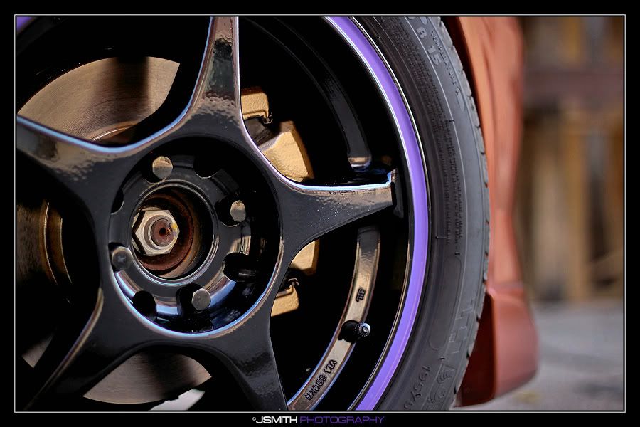

Given you're in Quebec I honestly wouldn't even bother, as sadly given what you guys use for "preventative road salt" absolutely rusts anything and everything out. lol
None the less, painting your calipers and the length of it lasting all comes down to proper preparation. I did mine earlier within the year, and they're holding up fantastically.
