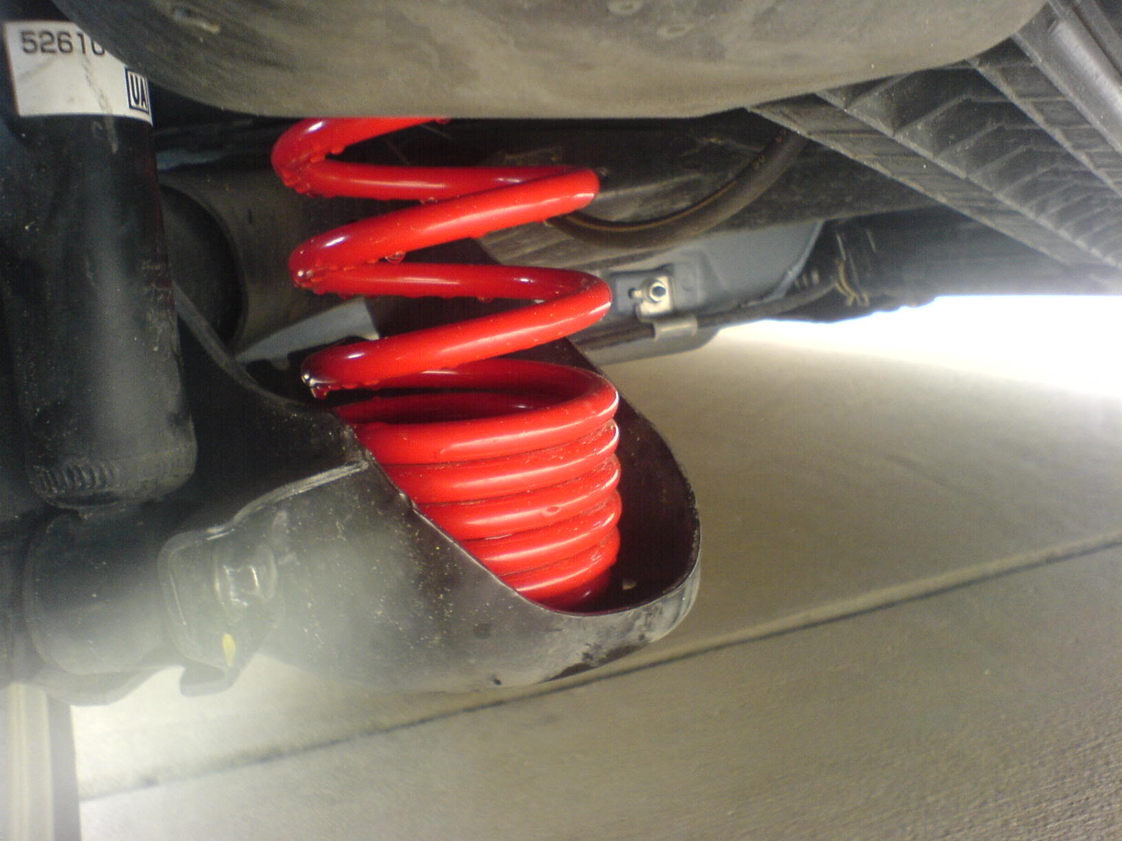

rear(skinny)

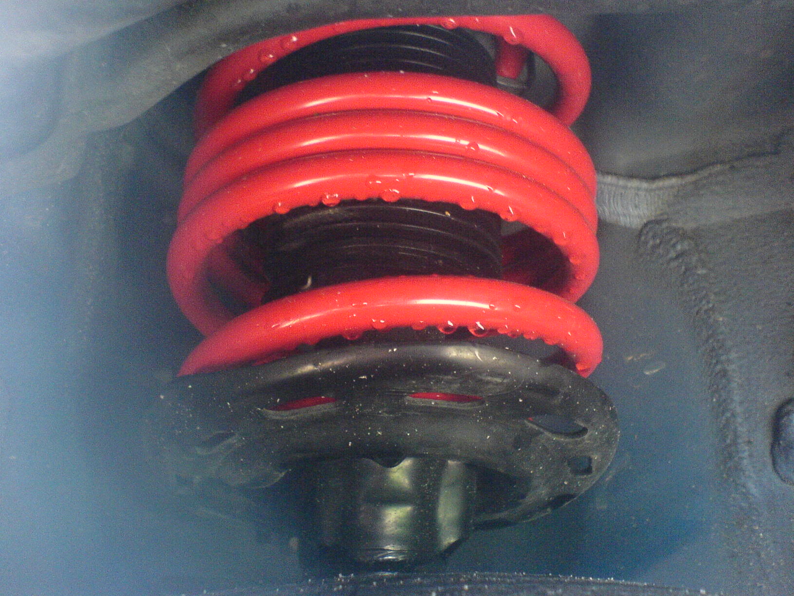

front (fat)

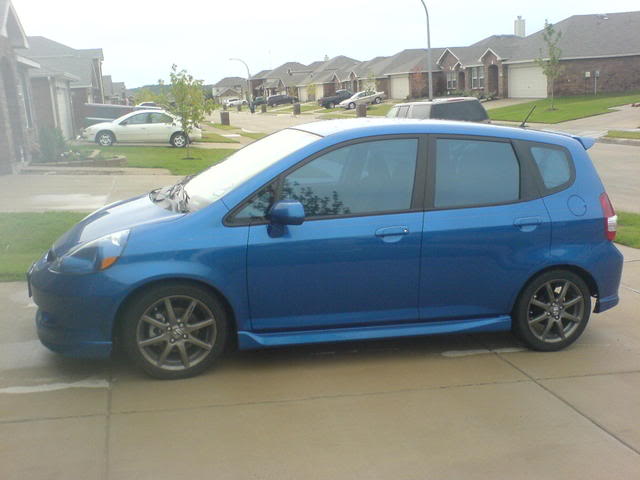

rubber is there just to prevent it from squeaking. The drop should look even all around. If not then recheck how the spring sits if its on the grooves correctly in the front. I remembered they needed to go all the way in like a screw.
after install
