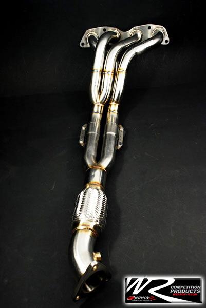

I am looking for more torque on my Fit, but am limited to "bolt on" mods for my racing class.
I have a 1.5. I also have a Hondata Flash Pro tuner for it. To even get ANY more torque for better response and acceleration I am working with a LONG tube 4-2-1 race header from Weapon R. It looks like this:
BUT, that has a whole host of other supporting modifications AND a full engine management re flash. EVEN with all of that, my realistic goal is still only around 110whp/100tq. Un less you turbo or put a cam in it, there really is not much more to extract from the L series...
