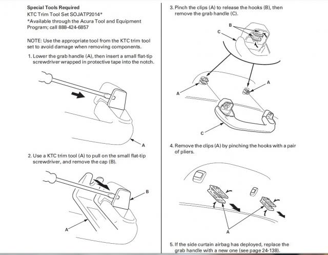

Just wanted to see if anyone had any tips for removing the coat hook from the hand bar thing over the rear passenger door? I have hit my head on it several times when getting out from putting our child in their car seat. Thanks for the help!

Not sure if this will help or not. Here is how you remove the Oh Shit handle on a GE
