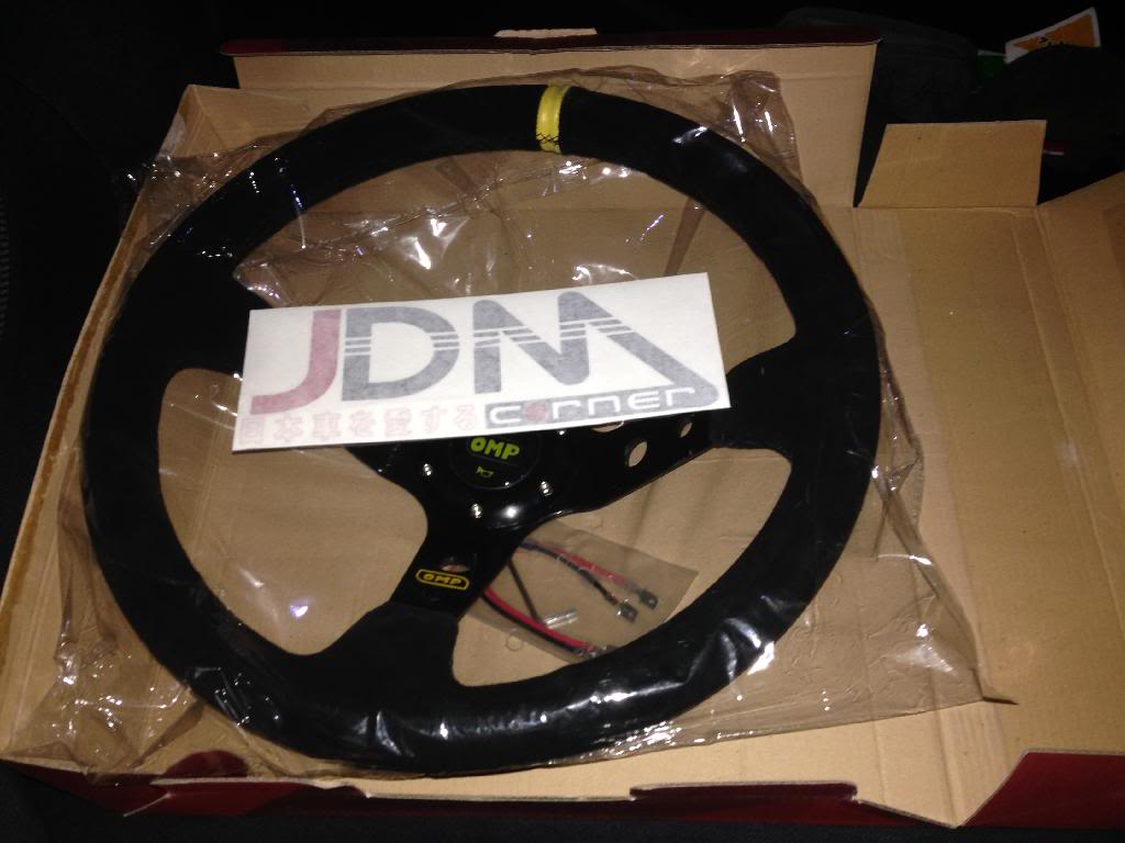

Just brought an OMP steering wheel. I was wonder if anyone could help me with which steering hub boss kit to buy? I heard that civic boss fits but unsure which civic... Is EK or EP boss kit? Please leave your comments and let me know which one i could get thank you fitfreaks 😊
Heres a photo of the wheel...
EK civic boss or EP civic boss kit?

I'm not 100% sure as I bought my hub used, but based on the works bell page:
WORKS BELL :: ホンダ車用ショートボス
Looks like the EP would work?

EK civic/CL1 Euro R/EP3/DC5 Type R Integra should all use the same bosskit. If you have airbag fitted steering wheel, you'd want to get one that fits airbag fitted vehicles, and has a cancellation plug for the airbag light
