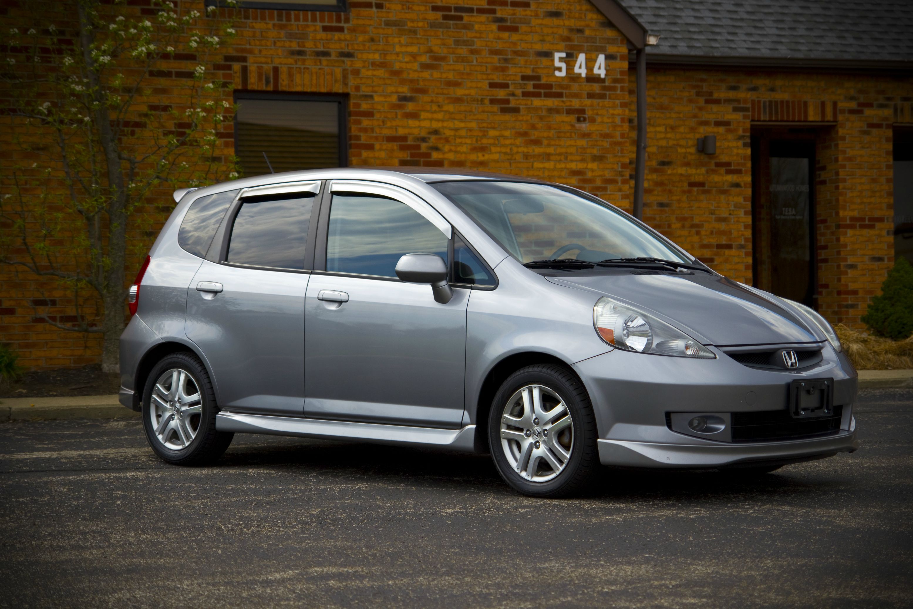

Old Apr 26, 2014 | 04:35 PM
redludesh's Avatar
Joined: Mar 2014
Posts: 25
From: Ohio
Well I pulled the trigger. Fingers are crossed :-)
Old Apr 27, 2014 | 04:05 PM
ikutoisahobo's Avatar
Joined: Feb 2014
Posts: 722
From: Las Vegas
Awesome photo!
She looks so clean. Are those body colored visors?
Old Apr 27, 2014 | 06:44 PM
redludesh's Avatar
Joined: Mar 2014
Posts: 25
From: Ohio
They are :-)
