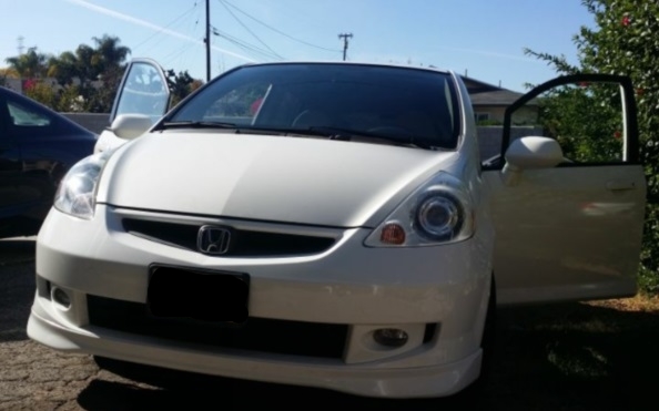

Work has taken up quite of bit of time lately, but I did get around to a couple pictures! (excuse the poor quality of the pics, I don't have a nice camera)
The FX-R projectors I installed are the 2.5 inch version, and with the Apollo shroud, it gave the retrofit an OEM kind of feel.

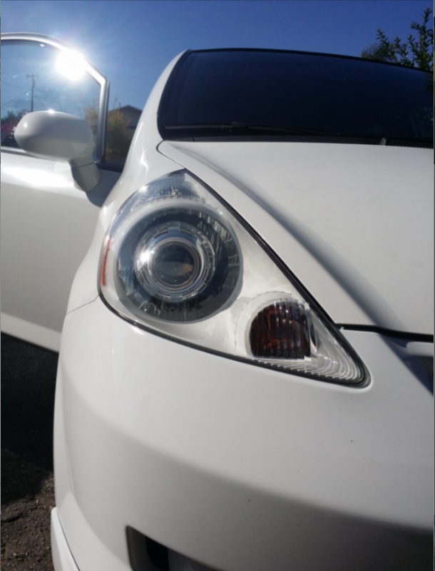

The FX-R's output is so much brighter than the Mini H1's. My friend said it's like driving in a sea of white light at night.

They look nice!

very nice clean retrofit, yours look like OEM from the factory, high quality
