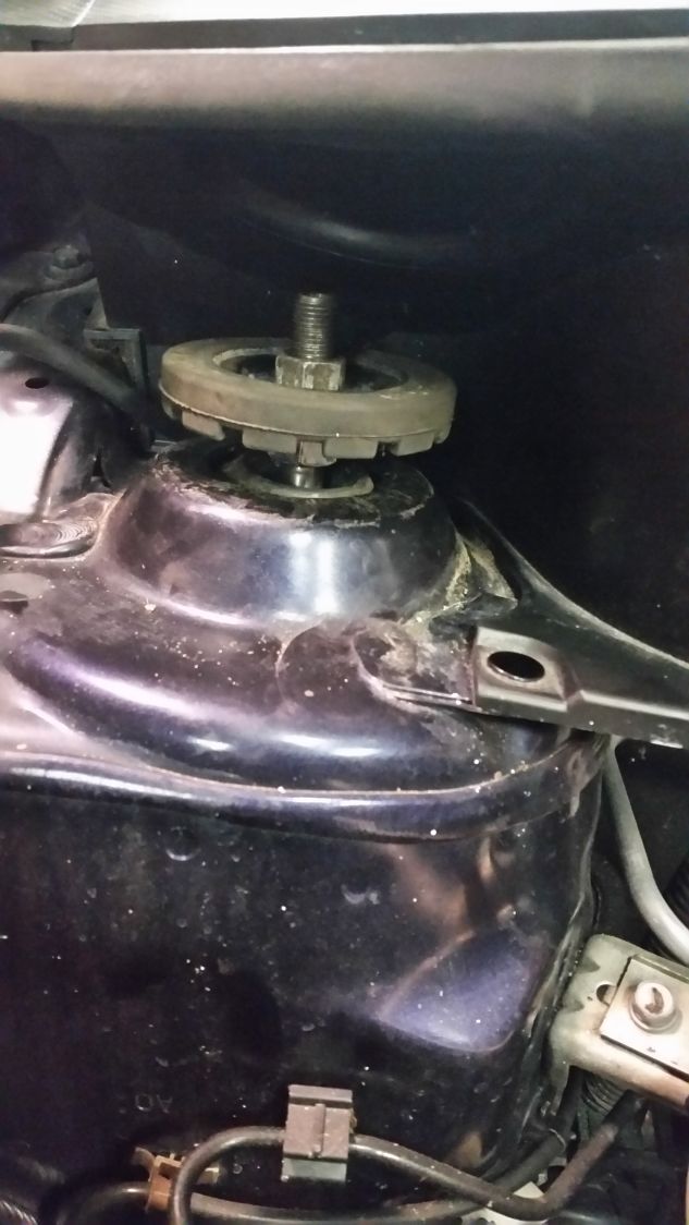

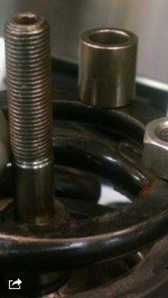

Can any of you by chance suggest whats going on here and what I'm doing wrong?..
Attached Thumbnails 2008 fit, new to scene, have questions..-80-20160124_200443_80396d1c28ffa4289ac42d64b13d9b4fca9c743a.jpg

Missing a little sleeve like thing.

Little metal one? I have figured that part out. Just can't figure out where it goes lol

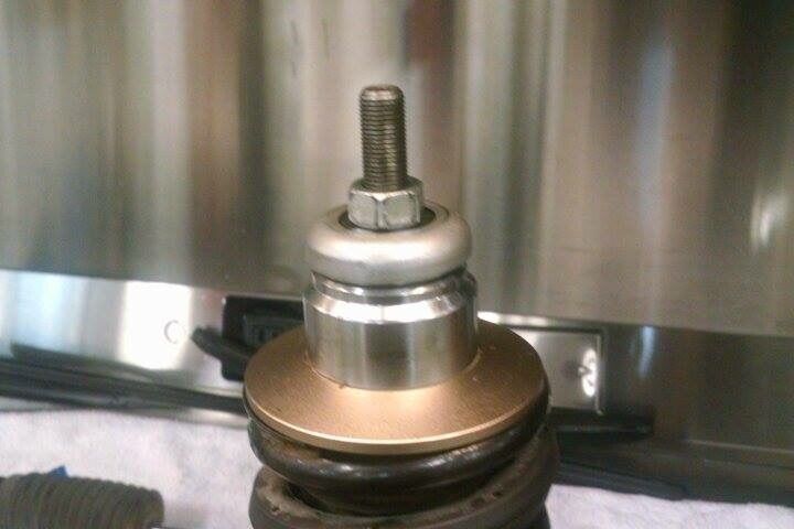

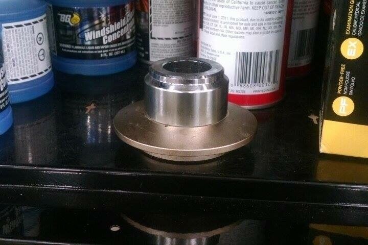

Little thing first, then that top hat, then the bushing/bearing then a nut
Attached Thumbnails 2008 fit, new to scene, have questions..-80-image_2ca7a9219bafa39ed2453c8dc27c0989cefb663d.jpg

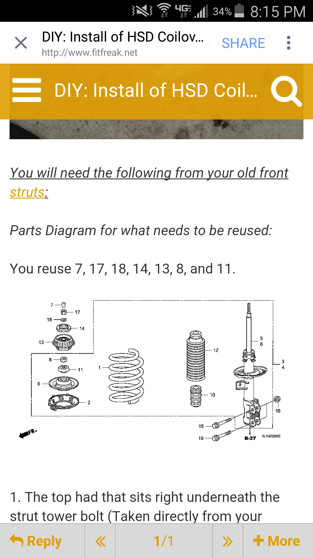

So that's where a fuck up, so spacer thing goes in between 8 and 11 on this diagram?
Attached Thumbnails 2008 fit, new to scene, have questions..-80-screenshot_2016_01_25_20_15_59_215be6c92ce005cdf9992055f319e26eb13e617a.png

It goes first then BC top part, then the bushing. Then a nut then the top
Insulator.
Old Jan 25, 2016 | 10:49 PM
  #36
swade's Avatar
Joined: Apr 2012
Posts: 271
From: Joplin, Missouri

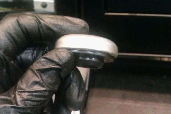

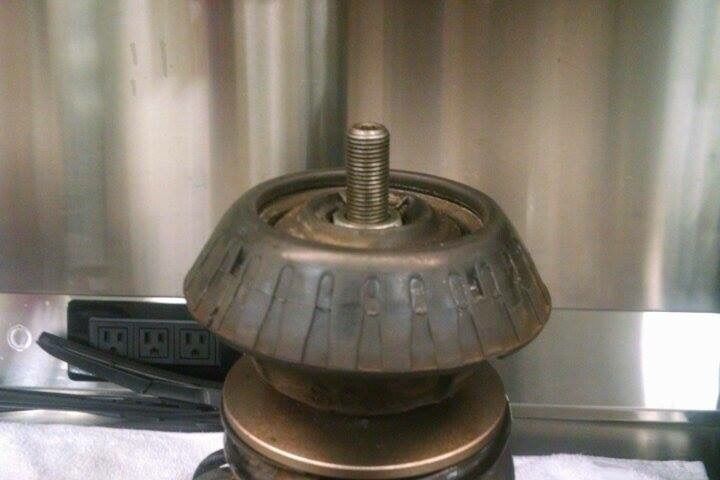

This 2nd
This third
Then a nut
Then the rubber isolater
Attached Thumbnails 2008 fit, new to scene, have questions..-80-image_ca1d17e237036f5d04fb8088862bb8f43a6a37ad.jpg   2008 fit, new to scene, have questions..-80-image_563ad36655e44978d940383a289278a11183a981.jpg   2008 fit, new to scene, have questions..-80-image_ba34a08a9c4e7bd2f79737f21609f16578917a51.jpg   2008 fit, new to scene, have questions..-80-image_fe74da5768fa219a9d58a9179c398c5b8399ff09.jpg
Old Jan 25, 2016 | 10:50 PM
  #37
swade's Avatar
Joined: Apr 2012
Posts: 271
I believe that to be right. It's been awhile since I've messed with BCs
