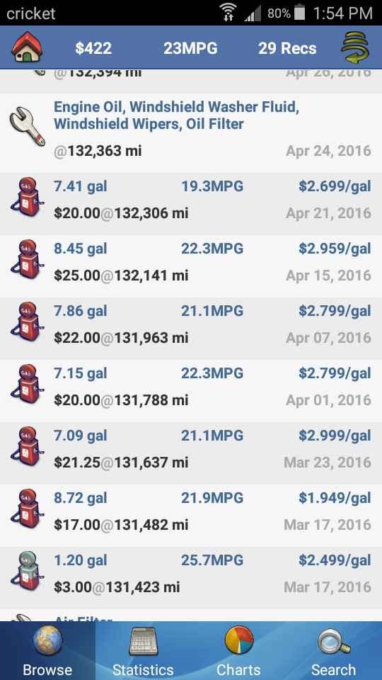

So far so good, my two last fills returned 26MPG with a drving of both highway and city (50/50). I am going to travel this weekend so I should get a higher MPG. I will give an updated on Sunday probably.
These were the last fill-ups in my car before changing the coils. I use aCar to keep track on everything on my car. From November of the past year the highest MPG was 25.7.
