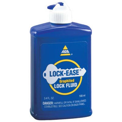

I'd do this first...use a graphite lubricant made for the application, such as Lock-Ease.
Also, verify that it's not just a worn or bent key. Do you have the same problem with the second key?
