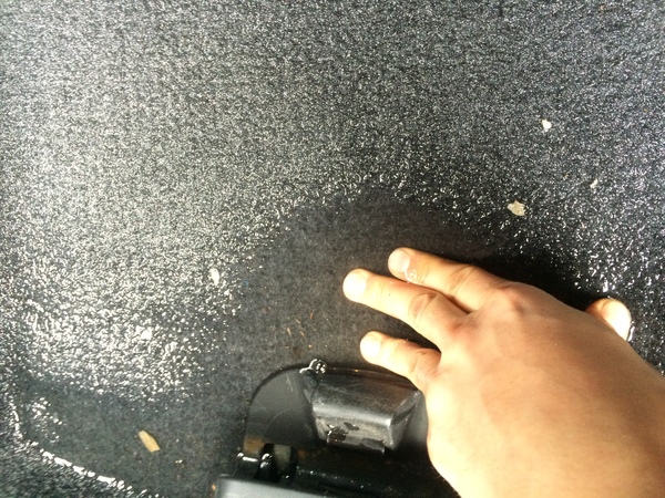

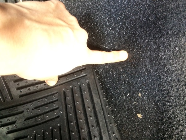

Well it all started this winter (2015/2016) when I noticed some ice buildup on my rear passenger carpets of the 2007 Fit I had recently bought in December. I really thought it was weird but didn't investigate more than that. Lets skip to spring 2016, when it started to get a bit hotter outside I decided to vacuum my Fit. Turns out there is a huge puddle of water submerging my backseat carpets. At this point i'm freaking out, pull out the iphone and start searching on google. As it turns out many GD3's have this problem. I continue my research and I find more water in my spare Tire compartment. Found a couple of threads on FF that helped me with the problems. Let me walk you through the fix for BOTH of my leaks since the leaks come from two seperate places.

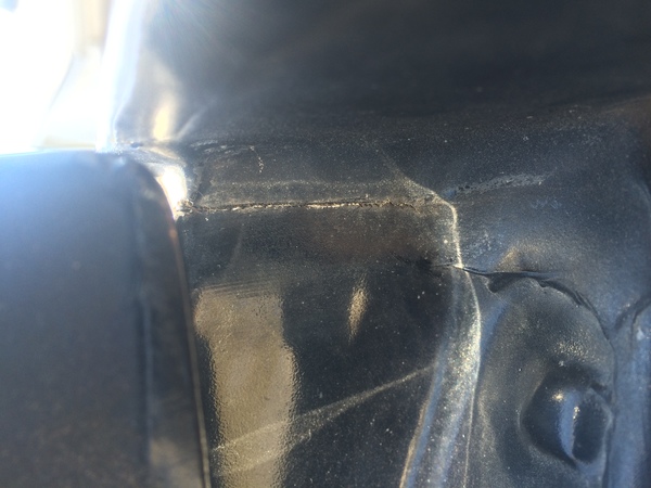

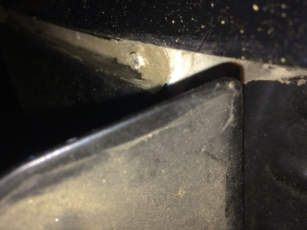

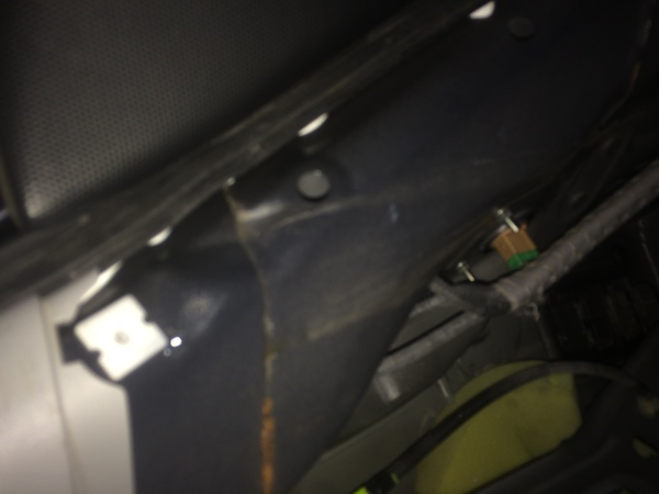

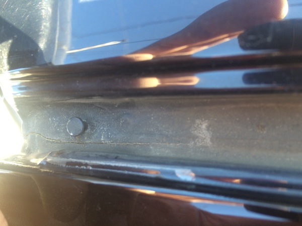

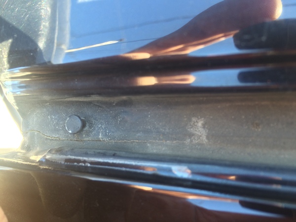

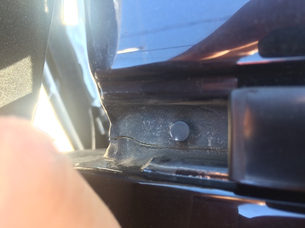

1. Cracks right under gutter weather strips, above the hatch hinges.

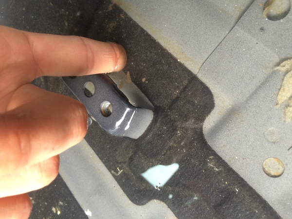

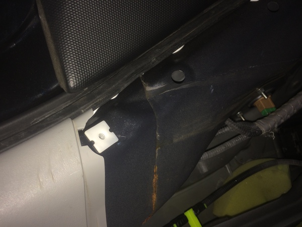

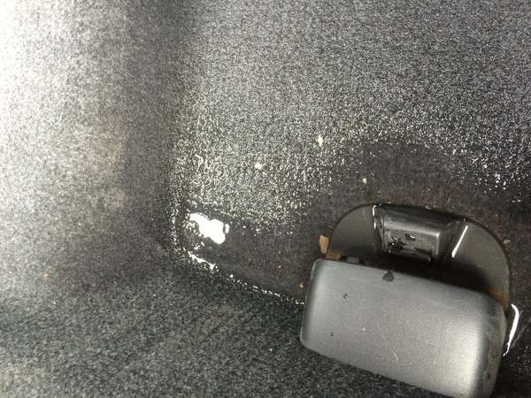

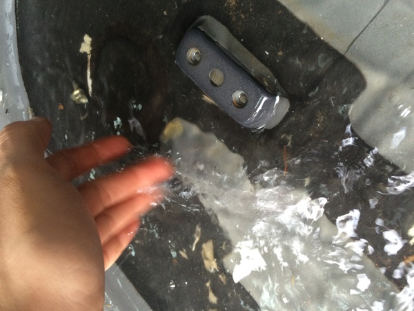

These hairline cracks are the main source of the water coming into the spare tire compartment. The water comes down the inside struts surrounding the hatch opening. Heres a few of the pics of the water i had in there, it was pretty bad.

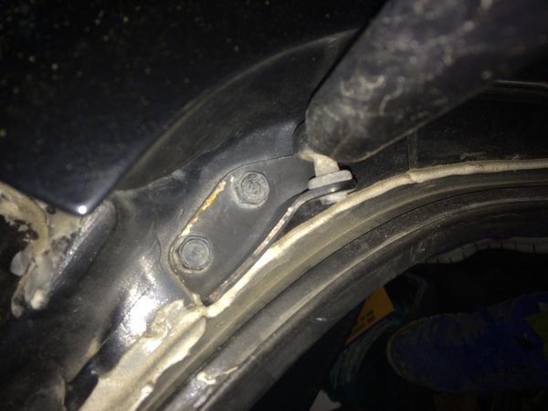

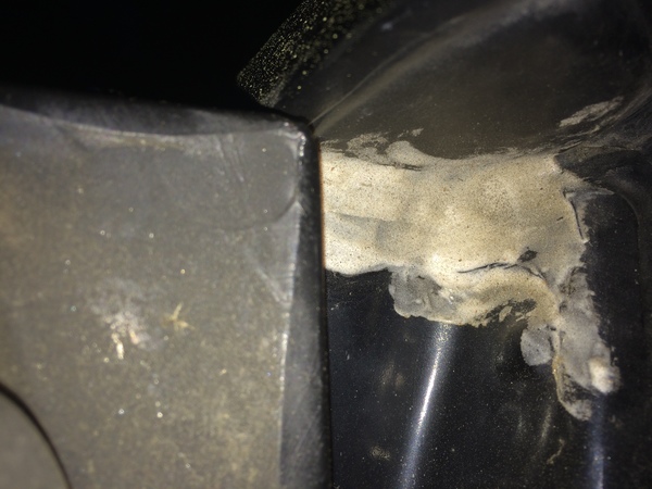

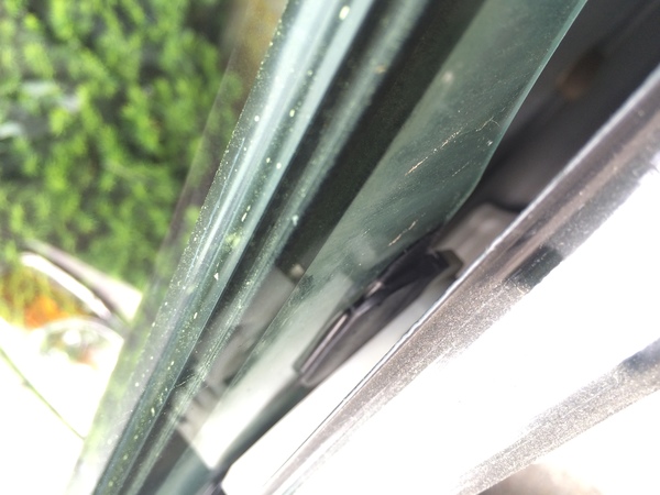

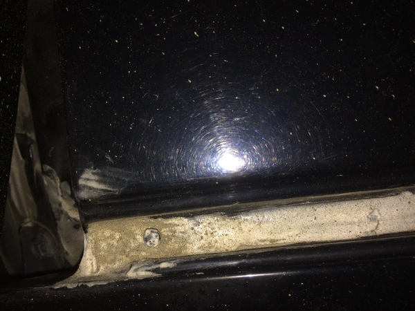

When i found these cracks thanks to other threads across several forums, I fixed them with waterproof silicone, although the dealership suggested using a body compound. I did it the quick and easy way and will hopefully hold up. after 2 months this is what it looks like, (sorry for the pics, it was night out and i really wanted to take em for this thread) The silicone accumulated dust but that is pretty much it, still holding up.
P.S. I thought at first it was the hatch seal so i filled it with silicone. The hatch seemed to leak from there also but the main leak was the cracks.

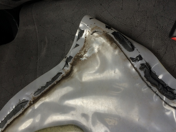

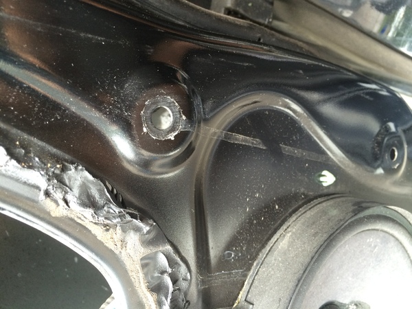

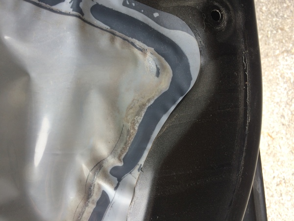

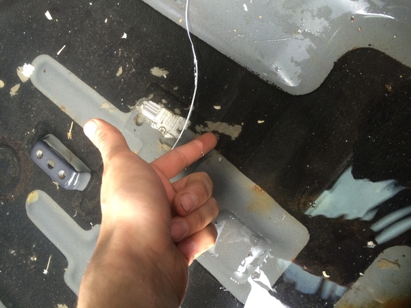

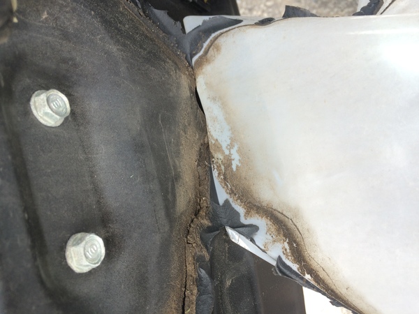

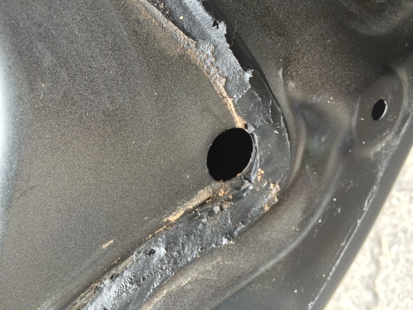

First off the water leaking in starts from the window. It seeps in and usually is supposed to leak down OUT of the bottom of the door where it seeps outside of the car. The problem is inside the door , between the exterior panel and the inside plastic cover is a wall which holds the components of the door. On this wall is a big opening which the water can go through. Now usually, the water hits the plastic vapour barrier and leaks to the bottom where a hole in the wall allows the water to seep back in the door leading the water to the drainage holes at the bottom of the door. The problem is that the glue holding the vapor barrier fails at certain points and causes the water to seep through. You can see in the pictures all the grime the water left behind.
The fix is easy as you can see on Rods Fit Page. ( Ill post my pictures later for this fix.) These leaks are more common on the left side of the car as opposed to the right side. The rear left passenger is more common than the driver side. I didnt have time to check the driver side so ill do that once i have more time on my hands
