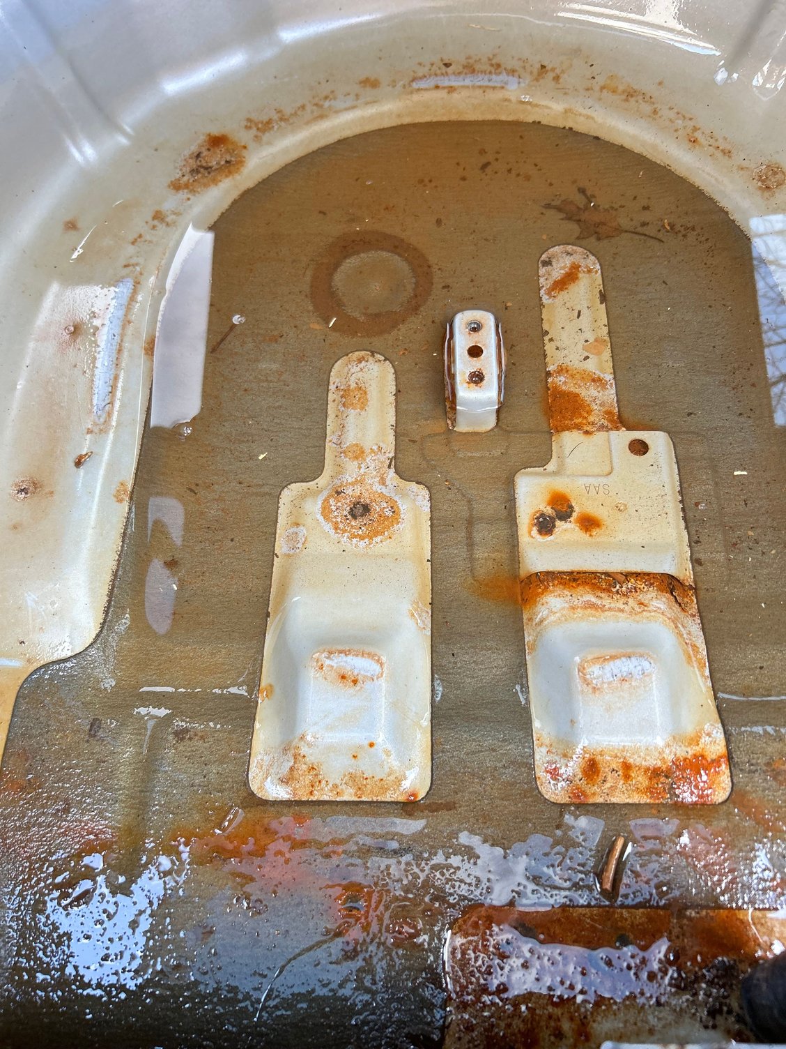

Old Apr 12, 2025 | 07:55 PM
GinoLicious's Avatar
Joined: Aug 2013
Posts: 580
From: Oakville, Canada
What area did you guys need to seal? I’m getting massive pooling of water in my trunk and am curious where I’m going to need to seal. I intend to use polyurethane to seal it. Properly the brand DAP and a caulking gun. Form what you all are saying I should just run a hose on my roof and around my tail lights and have someone sit inside and see if the water starts to pool again in the spare tire well?
that’s the mess I noticed. And now understand why my car stunk like dirty water.
